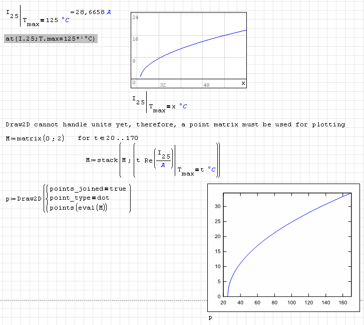

Normally, you would keep the parameters which are subject to later change as function arguments in the definitions. E.g. all quantities should be defined as function of T.max.
However, given the sheet as it is, the simplest way is to switch off the numeric parameter specifications. That enforces SMath to store the symbolic formula and you can afterwards apply the substitution operator (at() function).
Drawback is that you do not get numeric results unless you either provide global values by just defining them in the sheet (can be done below all other definitions) or by specifying local values using at().

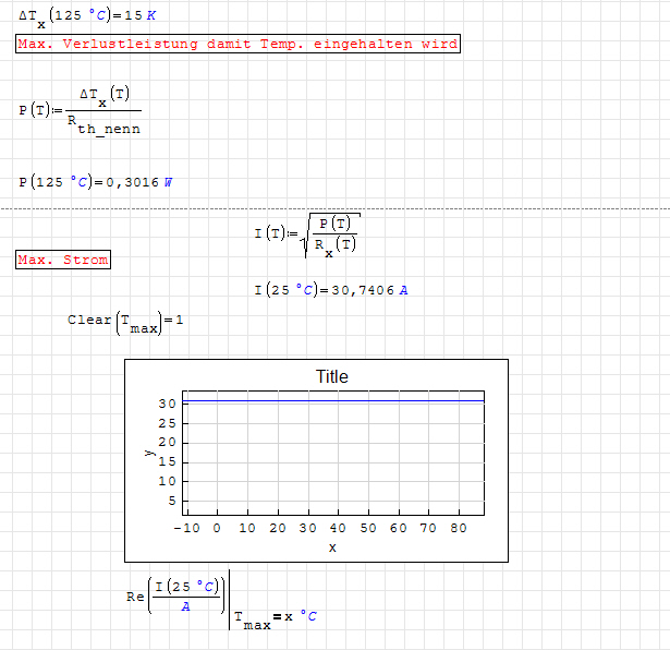

Additionally, it would be great, to use the X-Y Plot Plugin instead of the build in function, is it also possible?
#7 Опубликовано: 10.03.2014 08:54:56
It is essential that DeltaT.x is stored as symbolic definition with T.max not replaced by a value.
Downstream the sheet you can give it a value for displaying results.
For plots, you have to clear the value and use the substitution operator. Alternatively, you could define DeltaT.x as a function of T and T.max in the argument list and do as well for all other defintions. Then you just could call I(25°C, x°C) instead of using at().
This is something I tried to do, but when there are more than 3 variables it becomes rapidly confusing.
So I think the at() function is the better way.
I tried to use it just like you did, but the value doesn't change.
I changed the formulas to symbolic.
Whats the issue?
Thanks for your help and time.
#9 Опубликовано: 10.03.2014 19:16:15
As I said, the definition of T.max must be after the definition of DeltaT.x, otherwise the numeric value is stored in the definition instead of the symbol. Hover with the mouse over the definition of DeltaT.x in order to see what is actually stored.

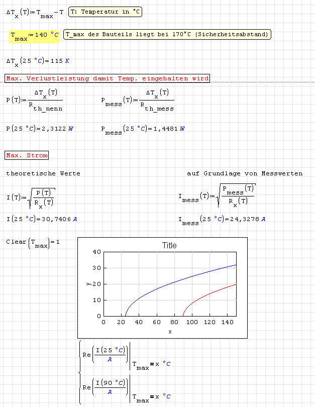

#10 Опубликовано: 11.03.2014 03:01:45
freakyuser1
freakyuser1
1 сообщений из 7 понравились пользователям.
OK, with the mouse over it's plausible.
But it only works, when I write T.max under the definition of I(T), otherwise I(T) is stored also numerical and not symbolical.
The other way is, to clear T.max before every definition and define it again afterwards.
Is this the only possible way, or do I something wrong?
Drossel_berechnung_test_v2.sm (334,43 КиБ) скачан 1355 раз(а).
#11 Опубликовано: 11.03.2014 03:13:53
freakyuser1
freakyuser1
Well, one option would be to write the definitions on the top and the values afterwards, so everything is stored symbolic.
But also, the "documentation style" and the clarity would be lost.
