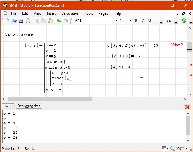

... and issues in composite functions with loops.
FunctionBug2.sm (17,71 КиБ) скачан 1376 раз(а).
FunctionBug2.pdf (76,58 КиБ) скачан 800 раз(а).
sergio 18.11.2020 16:45:00
#3 Опубликовано: 18.11.2020 16:47:05

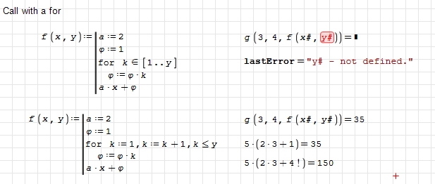

Debugging with trace(), what I see is that when calling g, f takes phi=1, (this is the first phi=1 in the output window) but don't do the loop. Calling f isolated shows another phi=1 and subsequent values for phi.
With for(3) gives an error, so I can't debug that. Additionally, calling with for(4) seems to have the same behavior than while.
