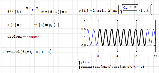

Because I don't know how to find the derivative of the arcsin of a complicated Jacobi elliptical si expression. Actually, Wolfram neither. In this version I restored the function sn and the derivatives are found numerically.

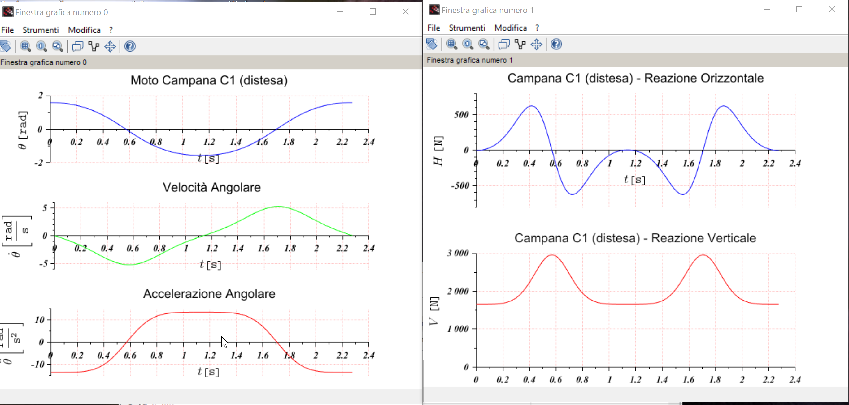

A long time ago I addressed the problem by writing this scilab script that I am attaching, omitting only the part for the production of the graphs. It also works to date. Maybe it can be useful to you, at the moment I don't have time to try to transform it into something Smath

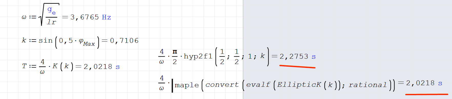

Only a annotation for the calculation of the "K" function: you gave two methods (indicating what you think preferable); The other method numerically provides the same value provided by Scilab and in fact two rather different periods of oscillation are obtained as indicated below (2.02 s against 2.27 s).
I have no mathematical knowledge so high to be able to evaluate this difference that does not seem to me to be of an exclusively numerical type.

Hi Sergio. You're right. I couldn't find the function among the plugins, so I looked for equivalent ways of writing it on the Wolfram functions site. However, numerical problems with a 4-variable function can be really serious. Surely there is some other, more accurate way, and one that doesn't involve using Maple just to evaluate a function, no matter how special it is.
https://functions.wolfram.com/EllipticIntegrals/EllipticK/26/01/01/
Edited: With this version of K it seems to work fine
Campana di Pompelmo v3.sm (1,02 МиБ) скачан 1715 раз(а).
