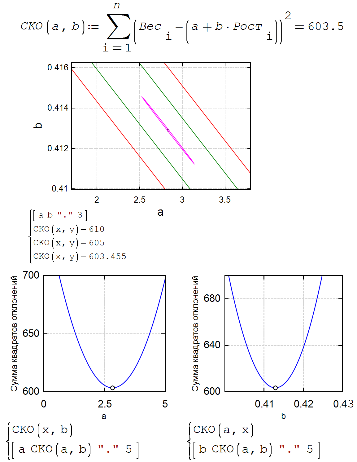

I have two 2D plots, but not one 3D plot with the minimum point.
Help please!

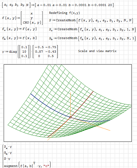

Thanks, but better so - a counter plot
6-1-Mister-Class.sm (30,03 КиБ) скачан 1266 раз(а).
#4 Опубликовано: 12.10.2023 14:47:57
Hi. Choosing CKO as z and using small ranges.
6-1-Mister-Class 3D.sm (41,91 КиБ) скачан 1302 раз(а).
