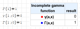

#22 Опубликовано: 11.06.2021 14:56:09
Sanity checked vs Mathcad 11.
Cuts the mustard a bit finer than first version.
Γ(1,0)="Uncertainty" unsolved.
There is no uncertainty in gamma_r6.
Everything look correct with those numbers.
Γ(1)=1
γ(1,0)=0
Γ(1,0)=1

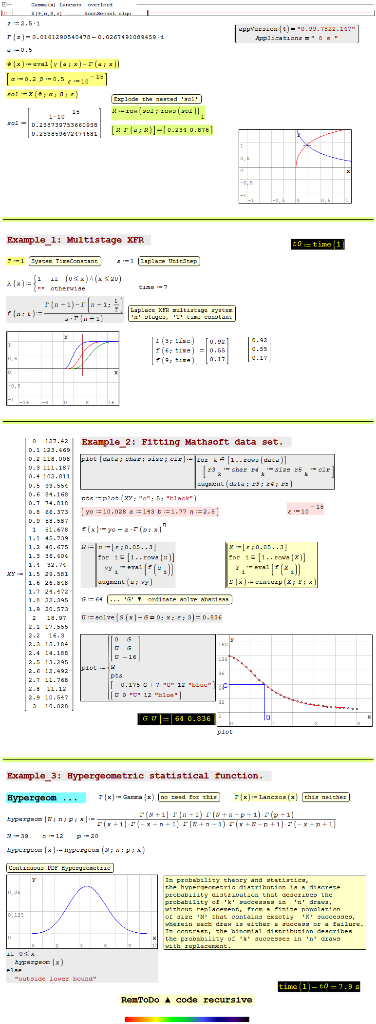

#23 Опубликовано: 11.06.2021 16:33:56
1. Example 3 ... added
2. Uncertainty solved for version not having 0 defined.
Gamma [overlord sr.6].sm (39,32 КиБ) скачан 1116 раз(а).

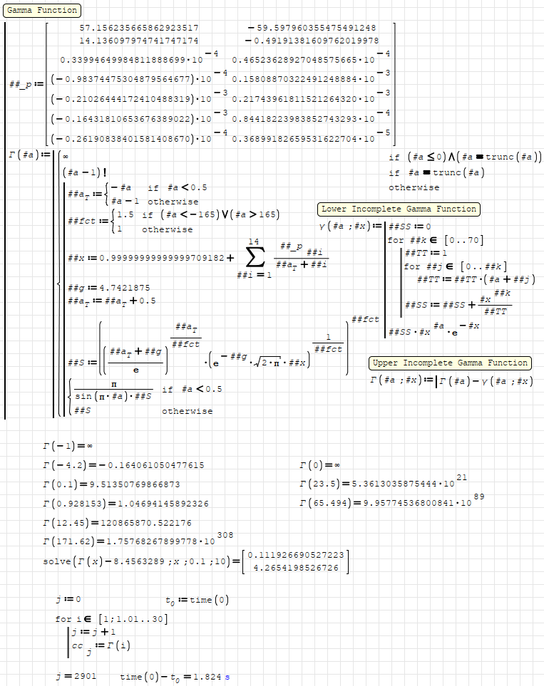

#25 Опубликовано: 12.06.2021 10:15:48
Hi overlord, of course you don't. My codes are mostly pedagogical, not for optimized for speed nor accuracy or something else. It's good to have codes with that.
Thanks, inspired by your code using sum(), and eliminating some useless variable definitions;
I have managed to speed up 30% percent under linux. And should be more precise now.
Only the 15th decimal digit may differs, and this is only sometimes.
Regards.
gamma_r7.sm (28,8 КиБ) скачан 1431 раз(а).
#26 Опубликовано: 12.06.2021 14:58:22
Apparently solve() can't read product() too.
Had to change algorithm style for incomplete function.
Hopefully this is the last version.
Well, I have my doubts... (swh)
PS: solvers may not found an answer just because variable names, Razonar's idea implemented.
gamma_r8.sm (29,61 КиБ) скачан 1419 раз(а).
gamma_r8.sm (31,51 КиБ) скачан 1453 раз(а). <---gamma_r8-2 (function variable revision)

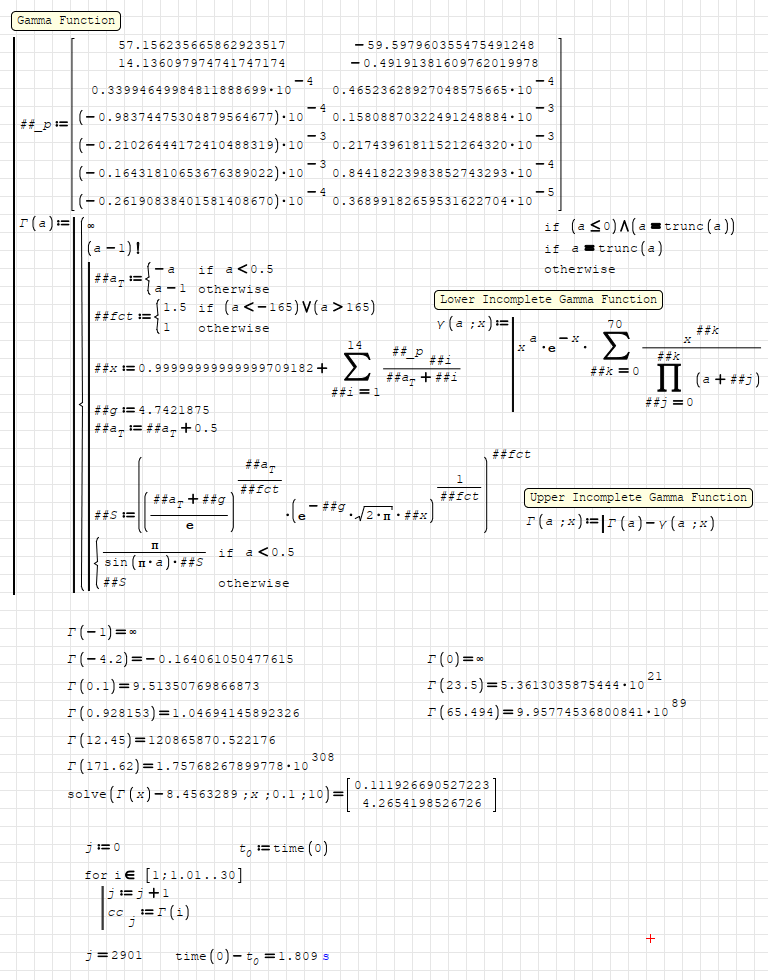

#27 Опубликовано: 12.06.2021 20:03:48
Regards.
The algorithm is valid for Re(z) > 0. See this notes please.
gamma.sm (27,93 КиБ) скачан 1874 раз(а).

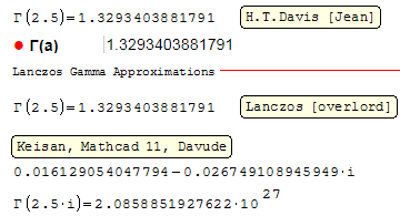

1. Smath Lanczos Davide code is 1/1 Keisan, Mathcad 11.
2. It supports imaginary argument.
3. It supports RootSecant.
4. Confirmed, your last Lanczos does not support RootSecant.
I haven't checked Alvaro suggestion.

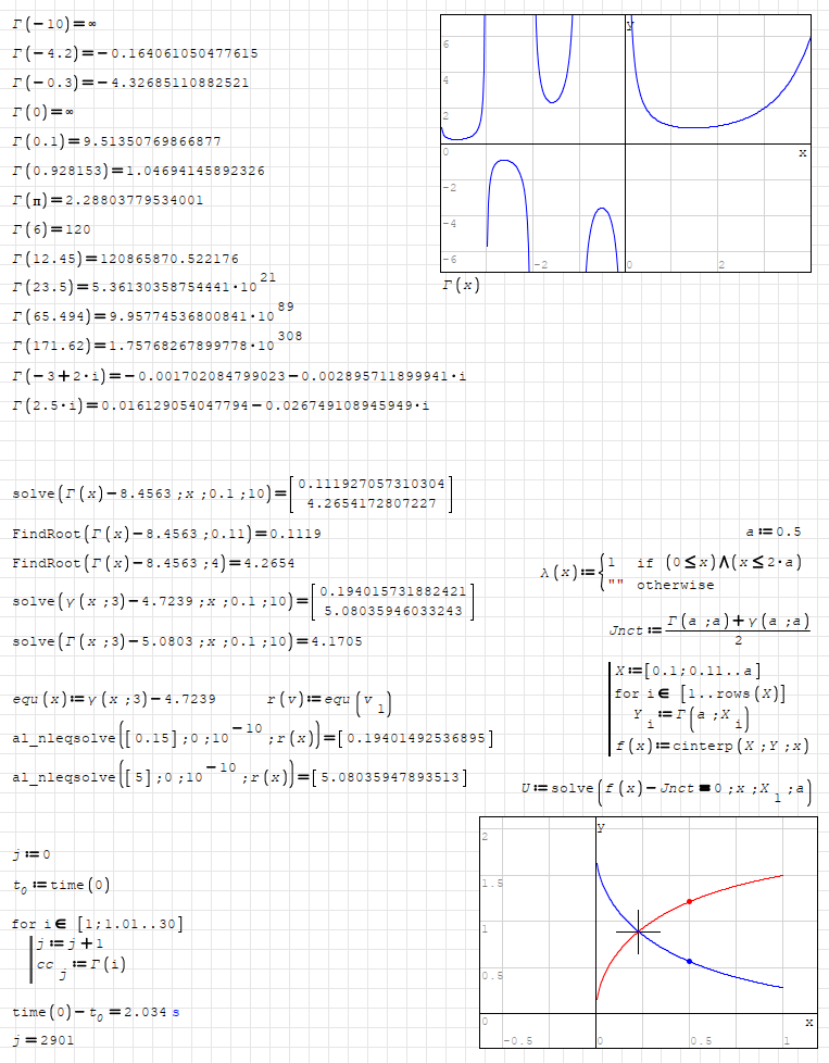

#30 Опубликовано: 13.06.2021 01:26:31
Imaginary numbers supplicated.
Root Secant better than HT Davis. (last digit)
Graphing works for all functions.
Usually all solve methods works.
gamma_r9.sm (36,93 КиБ) скачан 1827 раз(а).

#32 Опубликовано: 13.06.2021 15:26:22
Your latest sr.9 is mostly red in SS 6179, takes Eternity.
Who cares ^308 ?
On the other hand, could be damned slow in practical applications.
Because not being built-in in native Smath ... proof:
Lanczos plots Hypergeometric but takes 1 min versus resident Gamma(x).
Why not use Lanczos as given by Davide ?

Your PC is slow, your SMath_6179 is slow and broken, your examples are slow.
Gamma [H.T. Davis, Lanczos_overlord].sm (62,36 КиБ) скачан 1289 раз(а).
Gamma [H.T. Davis, Lanczos_overlord].pdf (155,73 КиБ) скачан 726 раз(а).
