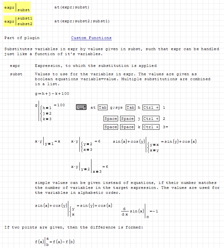

As on how to gain info: If you install the preconfigured portable distribution (see signature), the [?] button in the toolbar leads to a interactive manual.
The notation you ask for is provided by the at() function from the custom function plugin.
at.sm (21 КиБ) скачан 63 раз(а).

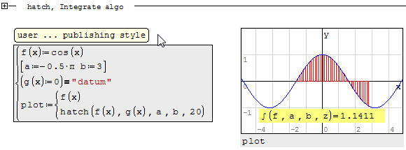

#3 Опубликовано: 11.09.2017 07:18:56
Integrate_0000 [ Introduction Scalar].sm (25 КиБ) скачан 60 раз(а).
