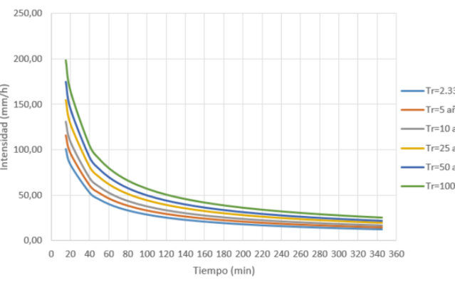

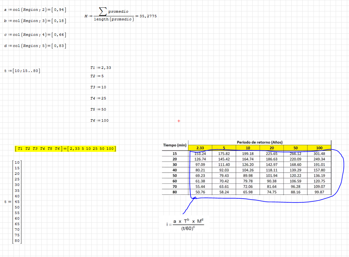

Hi, can someone help me with the solucion of this problem that i have, I need to create a matrix with the vector "t" in the first column and in the first row with the values ​​of "T1, T2..T6", and the matrix has to be filled with the equation "I".
FINALLY I HAVE TO GRAPH IN THE X-AXIS THE VALUE OF "t" AND IN THE AXIS AND THE VALUES THAT I FIND OF "I" FOR EACH "T1, T2 ... T6". IS IT POSSIBLE THAT THE CURVES ARE IN THE SAME GRAPHIC? LIKE THIS

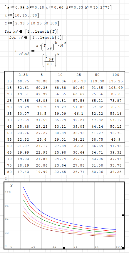

#2 Опубликовано: 21.06.2021 23:02:53
- Here is your table calculated with algorithm
- It is possible to plot multiple entities
matrix.sm (15,56 КиБ) скачан 1139 раз(а).

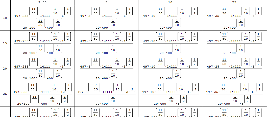

I AM TRYING TO DO IT, BUT WHEN I CREATE THE TABLE IT DOES NOT SHOW ME THE RESULTS ONLY THE EQUATION LIKE THIS,
CAN YOU TEACH ME HOW I DO IT PLEASE??, THANK YOU

I have done nothing special. It seems your table is shown as optimization-none.
I didn't know if there is an option for this, however your pc made it possible.
Update your smath and plugins to the latest version. Watch the video below.
If it doesn't work as it is shown, then this is a bug. File a bug report.

I found the error, thank you so much
#7 Опубликовано: 22.06.2021 14:20:06
... updated
Page8 Marcela.sm (20,61 КиБ) скачан 1268 раз(а).
#8 Опубликовано: 22.06.2021 14:37:18
I am just wondering, what was the error?
Could you please explain?
