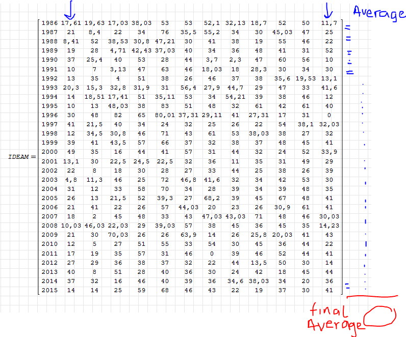

#3 Опубликовано: 17.06.2021 17:47:26
hi...I need find the average of each row (without include the first number) and at the end find the average of all averages....thanks for the help
Long version
Short version

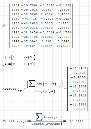

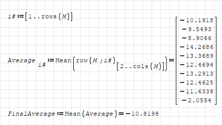

#4 Опубликовано: 18.06.2021 08:02:29
Had you attached the table ... job done.
Average.sm (9 КиБ) скачан 83 раз(а).

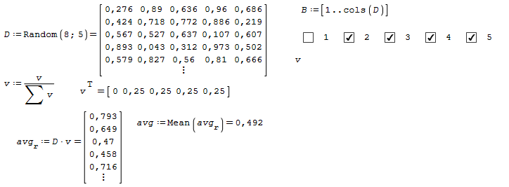

Another version with scalar product.
Easy to adjust to arbitrary subsets of columns.
avg.sm (6 КиБ) скачан 70 раз(а).
