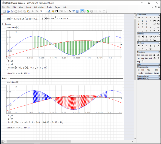

Here is a 'normal' page as it appears-

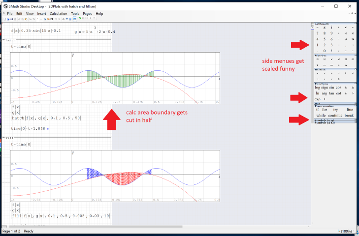

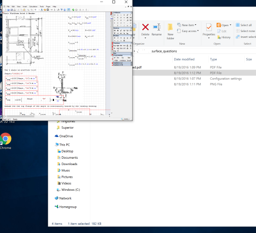

Here is SMath after it resized itself. The crop is the same size as the previous one
If I disable display scaling for smath, my page boundary for calculation area and output gets shrunk and the side menus get funky.
