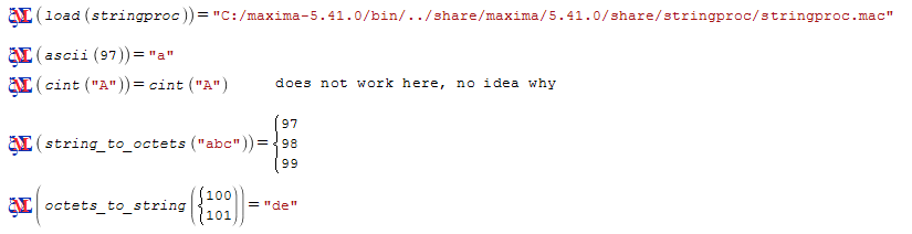

I'm looking for the equivalent to Excel ASCII functions
code("a" )=97 (space after " added to avoid a winking Smiley!)
char(97)="a"
and so on.
Does anyone know if they're hidden in a Plugin somewhere, or if there's an easy way to create them?

There are some conversion functions in Maxima.
ascii.sm (4,27 КиБ) скачан 1165 раз(а).

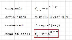

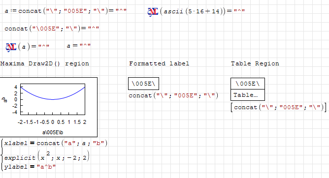

There seems to be something special with the characters generated this way. They will be backconverted to code sequence if used in Maxima region, label region or table region.
Zeichenketten.sm (57,75 КиБ) скачан 1098 раз(а).
Now I know why cint("A" ) does not work. It is a translation problem from SMath to Maxima, see SS-3543.

They are special indeed, you can see it by exposing the plain text with copy/paste... The syntax is handled at code level by the math region (like a bbcode or a markdown text)

This is strange. I understand that the \xxxx\ markup can be convenient at input time or if the characters are generated from computed codes. But why need they to be stored this way? SMath can store and display the corresponding symbols directly.
I'd vote for an instant conversion and storage as unicode character, at least for those which actually can be displayed.
This would be closer to the paradigm "what you see is what is done".
Because many characters are taken by the math syntax... +-*/.,:;<>(){}@#! (and many more)... converting the code in character may cause trouble while reading back the code.
