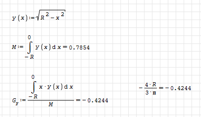

#2 Опубликовано: 09.05.2024 19:05:43
Hi Valery. This could be an option:
Using discrete contours you can see this Martin post.
