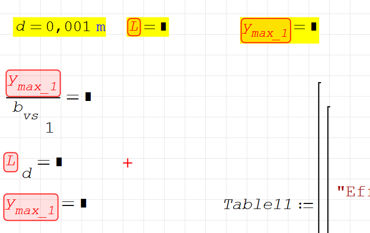

Hi Ale_Biaso,
Happy New Year to You and to all SMath users and developers!
1. Congratulations for your interesting and useful work.
2. Thanks for the extensive publication of this work.
3. It is not a simple task to check it all. That’s why I kept my first attention to identify the reasons of “red-marked” errors on your sm file.[/list]
4. Here are some identified reasons of such errors.
Simple pragmatic suggestion: when I have such errors, firstly I display the values of each term to see if they are already defined:
d is not an index; L is not defined, etc !
5. I keep ready to look for a further evolution of your work.
Best Regards,
Ioan

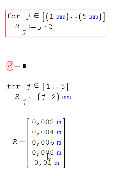

#5 Опубликовано: 11.01.2024 18:16:41
115 сообщений из 329 понравились пользователям.
In fact I see at least two incorrect or suspicious situations:
1) what appears to be an assignment is performed with = instead of :=
2) j of the for loop is a counter but here it is referred to as a series of values ​​with units of measurement. I'll show you a simple working example
Показать спойлер
Показать спойлер

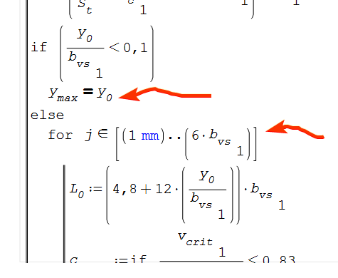

#6 Опубликовано: 11.01.2024 19:22:50
Hi Ale,
That's one way to do it (a backbone)
P.S. I'd suggest to use the multiple if/else instead of the nested if/else to improve the readability (just add more argument separators in the standard if/else)
