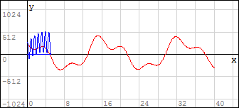

Hello SMATH Collaboratory,
Attempting to transfer a worksheet from MC Prime to SMATH. Couldn't get page 3 of my SMATH sheet to augment the x & y data for the graph; I tried a few variations , yet unsuccessful. I welcome any input(s)/recommendation(s).

Hi Nasch. This is an option.

#4 Опубликовано: 19.01.2023 12:11:52
Here's the updated worksheet.
Review of System Transients.sm (197 КиБ) скачан 68 раз(а).
The graphs differ some from the MC version, also some added data/lines in the graphs are exhibited.

#5 Опубликовано: 19.01.2023 13:50:20
Ah-h! I tweaked the 1st line under the "for" loop and the graphs are better.

#6 Опубликовано: 19.01.2023 14:07:12
WroteThe graphs differ some from the MC version, also some added data/lines in the graphs are exhibited.
Something like this ?

#7 Опубликовано: 19.01.2023 14:38:46
Hi Norm. This version returns the same plots. Initials conditions in yellow.
