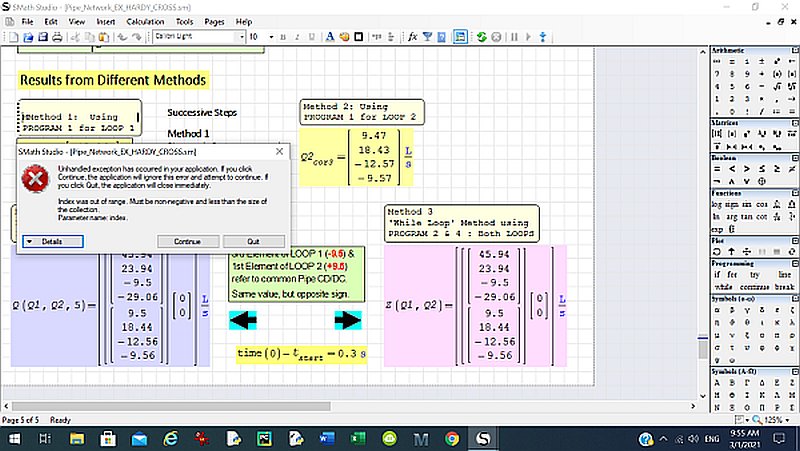

#7 Опубликовано: 01.03.2021 01:31:58
NDTM Amarasekera
NDTM Amarasekera
Whenever I try to edit contents of some description boxes the unhandled exception error message props up. For information of Developers please.
#8 Опубликовано: 01.03.2021 07:41:53
Please attache the content of the "Details" window.

Details Window.txt (30,14 КиБ) скачан 1186 раз(а).
Pipe_Network_EX_HARDY_CROSS.sm (299,12 КиБ) скачан 1471 раз(а).
#10 Опубликовано: 04.03.2021 08:53:47
Both issues fixed. Thank you!
