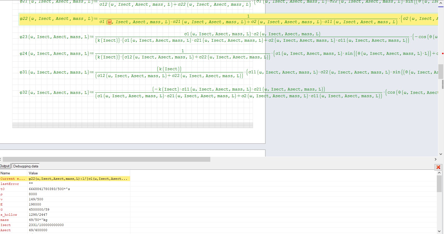

Hi JEAN,
I tried to run your last sheet (TMMT plot roots.sm) BUT a new bug (unknown until now) jumps out
for ALL my sheets involving TMMT algorithm (so, your sheet included....) : could you give me a hint
to solve it?
I'm very surprised and a bit upset: it's not matter of scientific calculation but debugging....
To be noticed that the bug involves SMath sheets previously working correctly (even if something was
signaled, randomly, in the past, for the same function BUT without any effect on calculations)
Many Thanks

.....sorry JEAN to bother you...but I've solved the issue I hinted before...apparently I have ticked (and forgot) the option "Pause" in "Calculation/On Error"...

original version of the my SMath file (ThreeHollowBeams_SteppedBeam) the calculation ended after 1h & 50' on solve (......) with the error message:
"No real roots"...I do not think it's matter of units (it worked in previous SMath files...). But on the other side, I do not know how could I ask to have even
complex roots...
Plus, do not consider negative axis and max the first 5 roots (lowest frequencies are always the most 'tedious' and a modal basis made by first 5 modes/frequencies
is more than adequate if we should want to consider an "answer" of the structure): this should limit the values (even if, to be honest with you, when I studied the same
cases in MathCAD, values of 10e18 were not uncommon).
Keep in touch
All done correct in few minutes vs hours.
Quick plot 10 min ... X_Y less greedy.
No imaginary roots encountered.

Fabbro, to the best of my knowledge, the line() function bypasses some of the Symbolic calculations, so it has the effect of just creating a definition, whereas before SMath was attempting to define and symbolically process (and simplify/combine) ALL of the preceding equations into the current equation.
May this be of Good Help;
