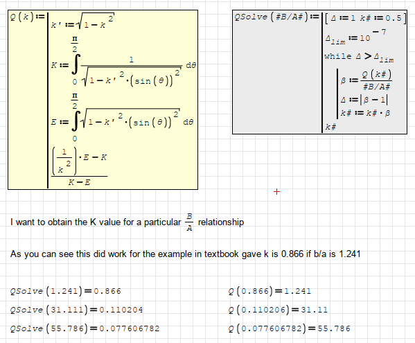

Good day everyone,
I am building a Hertzian stress calculator and got stuck at the step where I calculate the k value for a particular B/A reationship.
Any help will be appriciated

We also know than K will always be in the range (0,1)
The equations presented above is obtained from the book Advanced Mechanics of Materials by Boresi Et al

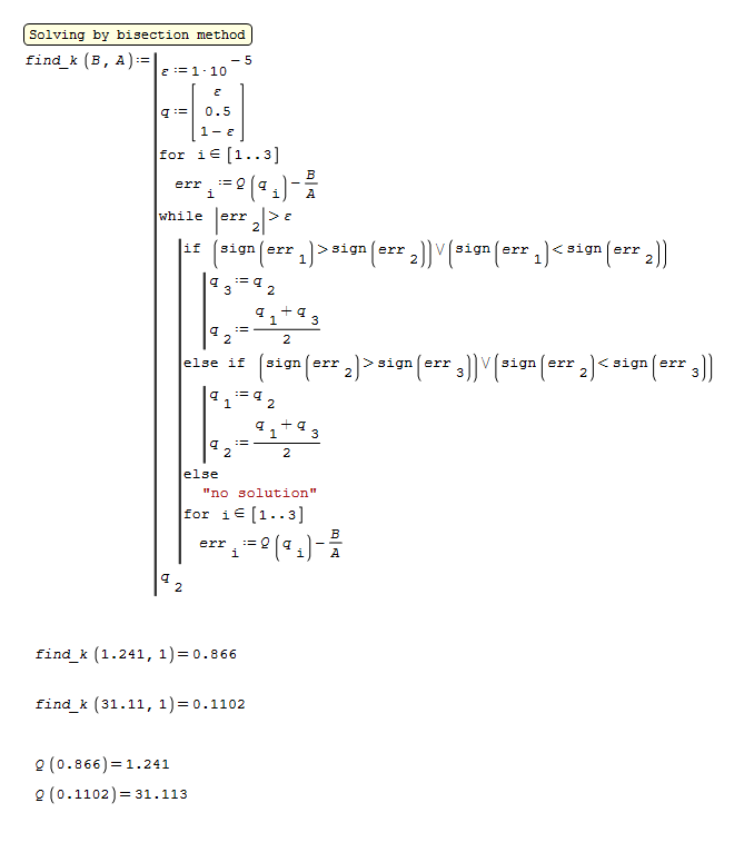

Solving by the old bisection method:
contact stress calc_by_bisection.sm (26,36 КиБ) скачан 1220 раз(а).
