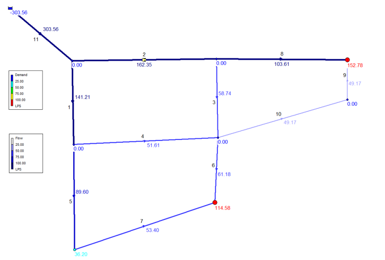

I have used Epanet to solve your exercise, by the Hazen Williams method with the following assumptions:
Minimum tank height 66 meters
the roughness of the pipe 120
node height 0 meters
diameter in millimeters
pipe length in meters
Carlos

Thank you Carlos.

I am extremely sorry that in my last example on 3 LOOPS, I have made a careless mistake in Program 2 to calculate the appropriate corrections in the network. The results were wrong.
Furthermore, for simplicity, I assumed a fixed friction factor instead of the method given in the original EXCEL file in the web.
The revised SM and EXCEL files are attached. They both tally. The original EXCEL file had only 5 trials and I extended to 10 trials.
Also, many thanks to Carlos for his example using EPANET which prompted me to check and correct my program.

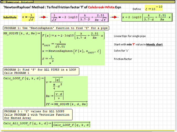

Hardy Cross method revisited.
The friction factor for turbulent flow is calculated using the Colebrook-White equation.
Due to the implicit nature of this equation, calculation of the friction factor requires an iterative solution via numerical methods. Hence, many explicit approximations have been proposed such as Haaland, Moody, Jain etc. to simplify the calculation process.
The attached sm file shows the iterative method of solving the Colebrook-White equation to calculate ONLY the friction factor ‘f’, for use in the Hardy Cross method. The calculated pipe flows were well within the values obtained in my last example.
Cheers.

Thanks for sharing the improved project method.
Take care ... Jean

This is very fine work indeed and much better than doing Hardy-Cross by hand like I had to do a few times in college back in the late 1970s. That 4-loop Hardy-Cross model I had to solve was almost enough to make me want to become a lawyer. Almost. :-) However, I now use EPANET and WATERCAD for my modeling needs and life is good. I also use Hazen-Williams far more often than Darcy-Weisbach/Colebrook-White and life is even better.
You mention above explicit approximations to Colebrook-White. This is a topic that has interested me since I learned of the Blasius Equation in college. Blasius does a decent job approximating the smooth pipe curve on the Moody Diagram, but only over a limited range of Reynolds Numbers. Over the years, I have run across at least two dozen published explicit approximations to CW. I even created my own improvement to Blasius, although it pales in comparison to some of the others.
Back in 2014, I published on the PTC website two Mathcad Prime 3.0 worksheets that evaluated these explicit approximations for accuracy and relative calculation speed. For accuracy, I used CW as the basis, even though it is itself empirical and includes an empirical friction factor. Computers are so fast now that relative calculation speed is not as relevant as it was when I started my career in 1980. However, it matters for calculator programs. I used an HP-41CX and it's built in time functions to measure and compare calculation speeds.
One MCP worksheet is for hydraulically smooth pipe (the equations simplify) and the other is for hydraulically rough pipe (the usual case). Y'all can find these worksheets here: https://community.ptc.com/t5/PTC-Mathcad/Lusk-Darcy-Friction-Factors-v2-zip/m-p/450068 . Don't worry if you don't have Mathcad Prime 3.0 or later. The .zip file contains Acrobat .pdf files for your reading pleasure. And, please excuse the funky page formatting near the end of each worksheet. These are big files and I had pushed MCP3 to its limits.

Thank you. Your explanation is welcome.
I don't have any experience in EPANET and WATERCAD.
My aim was to demonstrate basics of Hardy Cross method using SMath and and the importance of
the Vectorize function when dealing with nested matrices.
Stay safe. Take care.
Cheers.
In my Engineering times, before 1990, the Bible was Moody from standards.
There is nothing to explicit CW, it solves on the running Reynolds,
and for a family of diameters, just like in the Bible diagram.
Smath attached is 1/1 Mathcad 8 Pro [2000].
Inst_Colebrook MOODY.sm (16,88 КиБ) скачан 1438 раз(а).
