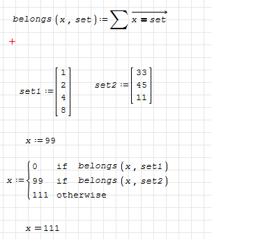

I have the question like this:
Is it possible to obtain a result depending on whether the variable belongs to the collection?
I mean the construction:
if x "belongs to" {1, 2, 4, 8} then x=0 else x=111
or even
if x "belongs to" {1, 2, 4, 8} else if x "belongs to {33, 45, 11) then x=99 else x=111
Thanks for an any response.
Jadalbert
#2 Опубликовано: 12.07.2019 09:27:29
Arie
Arie
Perhaps something like this?
elementsbelongs.sm (4,51 КиБ) скачан 1074 раз(а).
frapuano 12.07.2019 16:24:00

Thank You both for help. I tested both example and it works. But I dont understand how can I add new line to method (function) cases()? If it is the function cases(), may be I'm wrong. I mean:
x := {1 if ...; 2 otherwise
#5 Опубликовано: 13.07.2019 19:29:29
But I don't understand how can I add new line to method (function) cases()?
... like this
once you have if/otherwise [Cases], click right hand most place holder,
coma twice for one more if... again coma twice like before, DIY.
Cheers.
... like this
Cheers.
Ok, it works. But, I must use SEMICOLON twice. May be it is the same as coma (or comma) in real english. Im from Poland and my English is from school.
Anyway - thank You for help.
Jadalbert
#7 Опубликовано: 15.07.2019 08:41:38
That's because the more correct answer about arguments or decimal separators would be "press your argument separator" or "press your decimal separtor", since you can customize them in Tools > Options
