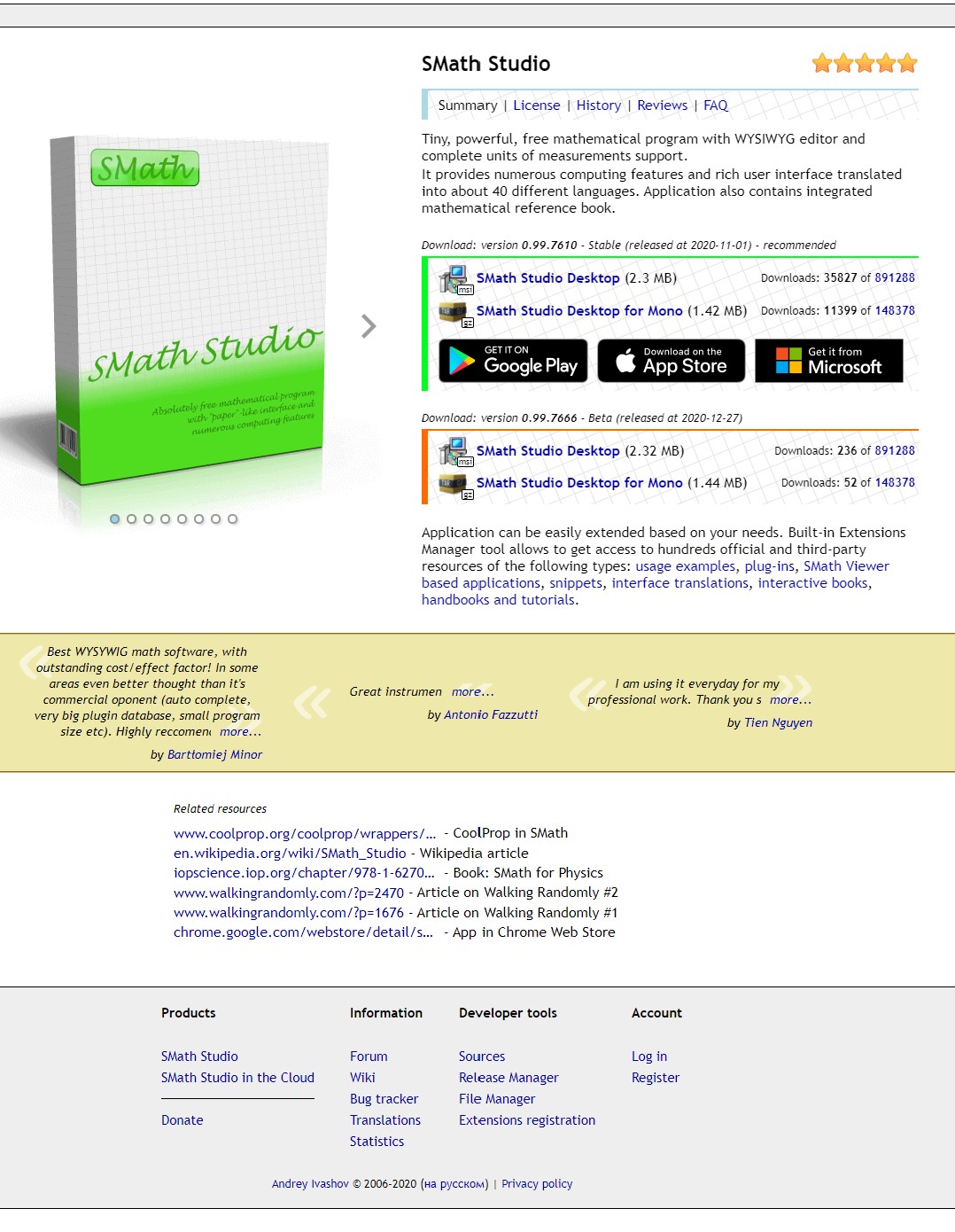

Davide - thanks again for the Reponses. When I try to go to "https://smath.com" I auto redirect to "https://en.smath.com/view/SMathStudio/summary" so maybe there is a difference.
Here is what I see:

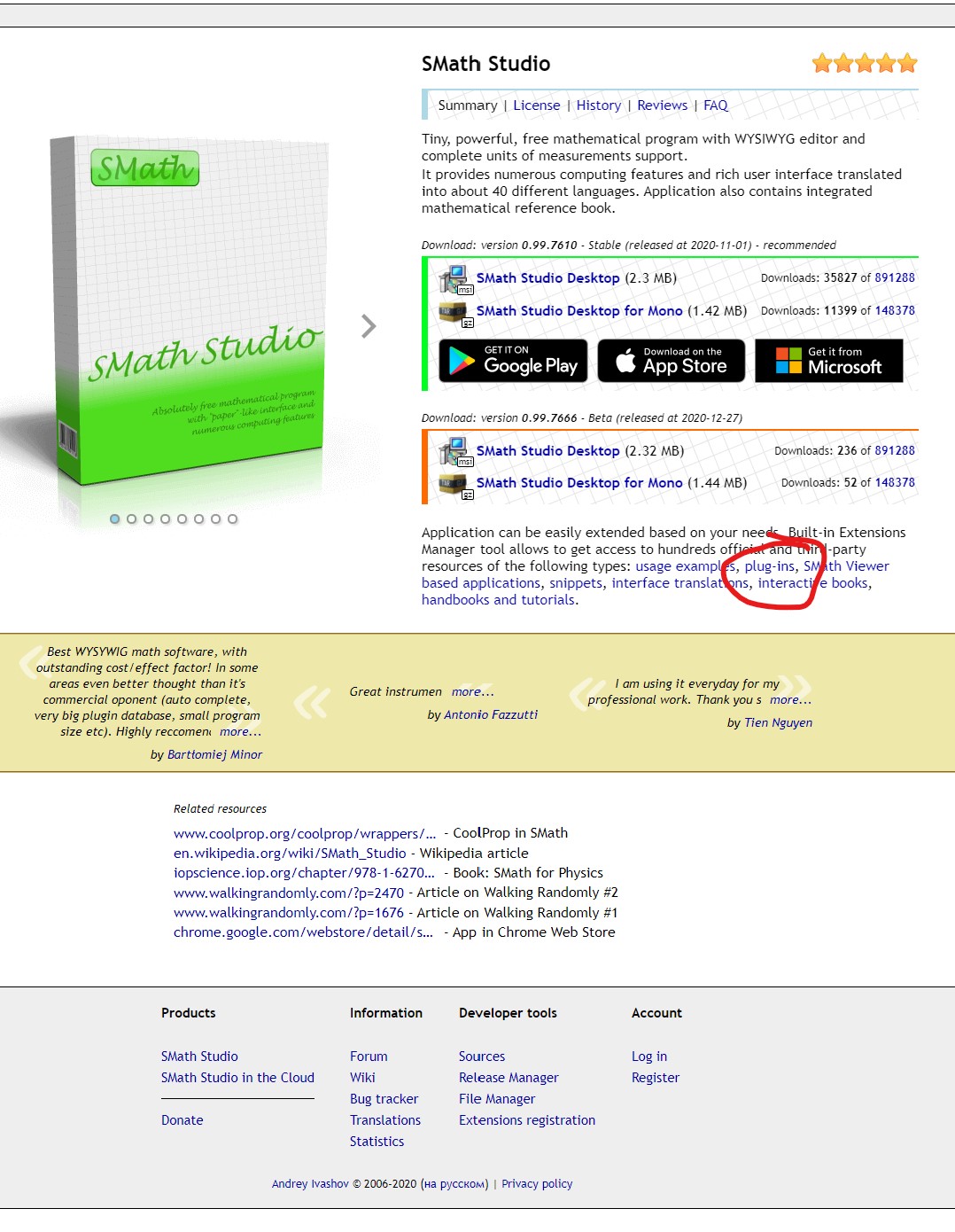

Sorry, nevermind, I found it:
