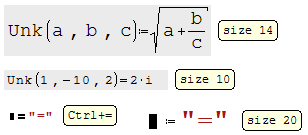

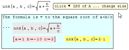

#7 Опубликовано: 08.11.2021 17:36:36
... You can compose text from Writer Region,
all sorts of symbols colors ... etc.

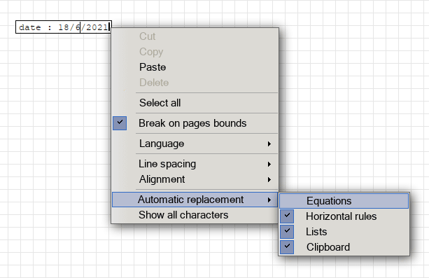

1 - How to enter the equal sign in as text?
2 - Anyway to make the icons larger?
1 - Deactivate equation replacement for text region.
2 - No way at the moment.

The "Automatic Replacement" choice under the Edit Menu
is also hard to find as it only appears after I type a word followed by a space.
So, same question...
Am I missing something on finding the "Automatic Replacement" option?
BTW, once I found the "Automatic Replacement" option and turned it off for Equations
It seemed I could enter just about anything with out sMath wanting to calculate...

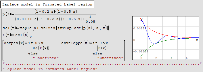

#11 Опубликовано: 08.11.2021 22:04:13
Formatted Label is exceptional for publishing.
Observe that the graph appears once all line arguments are executed.
That compacts the document(s) in more delicious visibility.

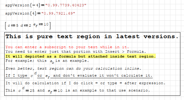

From the insert drop down menu ... Insert Text region.
yep ... = yep done
