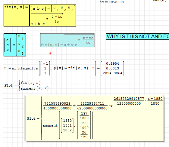

Razonar first gave me this formalism for al_nleqsolve. His formalism works perfectly; however, mine does not.
Here is my example SMATH file.
AL_NLEQSOLVE FIT.sm (20,48 КиБ) скачан 1662 раз(а).
Sorry, I forgot to upload the data file. Here it is.
WORLD EMISSION DATA VS DATE.xlsx (24,74 КиБ) скачан 1258 раз(а).

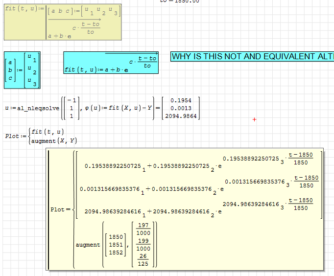

Two questions:
1. How can the plot of f(t,u) work because t is never defined?
2. I don't understand why my alternate formalism in the cyan box is not equivalent.
Thanks,
Reg
Reg CurryLoveland, CO
#2 Опубликовано: 13.02.2025 08:36:48
Hi Reg. You can see the result stored in Plot by hovering over it. In the case of the first option, Plot stores a one-variable expression (i.e., a single unknown, t) and a two-column matrix, so the graphs will be a univariate function and a set of points on the plane.
To analyze the second option, the nleqsolve set up is correct, but Plot fails to find the values ​​of a,b,c inside the fit function.
As a final comment, XY Plot can graph expressions with any unknown, while SMath's native plot can also do so, but only with the variable "x".
I hope this clarifies a little why the second option doesn't work.

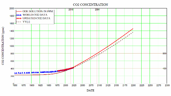

... Infrequently, SMATH crashes on me. It may be my 10 year old computer. When I include a separator in my file, and then try to move it with the mouse, it totally destroys all of my graph settings to the point that I have to delete the graphs and start over. This is how I move areas; so I thought I could move the separator the same way. If I add and delete spaces with the cursor and my keyboard that works fine. So, I have stopped using separators.
On my Windows too, on 32 and 64 bit machines. If I want to move an area, I collapse it, cut it and paste it to the desired destination.
My version has a discrepancy with yours, although I don't understand where it could be: I check them and according to me they should be the same. (Area in yellow)
CO2 FORCING SATURATION STUDY 2.sm (116,6 КиБ) скачан 1758 раз(а).
CO2 FORCING SATURATION STUDY 2.pdf (634,17 КиБ) скачан 1042 раз(а).
#11 Опубликовано: 17.02.2025 07:46:05
RegRetired
RegRetired
8 сообщений из 144 понравились пользователям.
I can only assume it is differences in the order of calculation between the two methods. Note that there is a slight difference between u.lin1 and u.lin2 in our versions. I assume it is the difference in how we define the subset of data between 2014 and 2023.
I have attached a pdf of my MATHCAD file that supposedly does the same calculation. There are small differences here also, but they manifest in a rather large difference in the result when the emission model reaches 1.5 °C. MATHCAD predicts 2128 and SMATH predicts 2120 for the same input constants…I think.
But we physicists usually do estimates to an order of magnitude. We are very happy with a factor of two. Our difference of 1233.2524/1156.6686 =1.07 makes us ecstatic.
MATHCAD CO2 FORCING.pdf (603,43 КиБ) скачан 1089 раз(а).
CO2 FORCING WITH SMATH.pdf (1 МиБ) скачан 1028 раз(а).
CO2 FORCING SATURATION STUDY W-EMBEDDED DATA.sm (593,32 КиБ) скачан 1914 раз(а).
I was not aware of the ODE solver; thanks for giving me more new information about SMATH.
I am becoming more comfortable with SMATH, although my long history with MATHCAD causes me to stumble frequently due to the small differences. One thing I really miss is MATHCAD’s plotting functions. I really miss the Trace function and the markers. But I can live with that if I am forced to get a new computer. Since PTC took over MATHCAD, they have stopped supporting MATHCAD 15, which is my version. Even though I have a perpetual license, they will not help me install it on a new computer. There a numerous negative reviews of PTC.

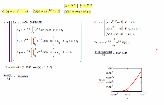

#12 Опубликовано: 18.02.2025 09:58:02
RegRetired
RegRetired

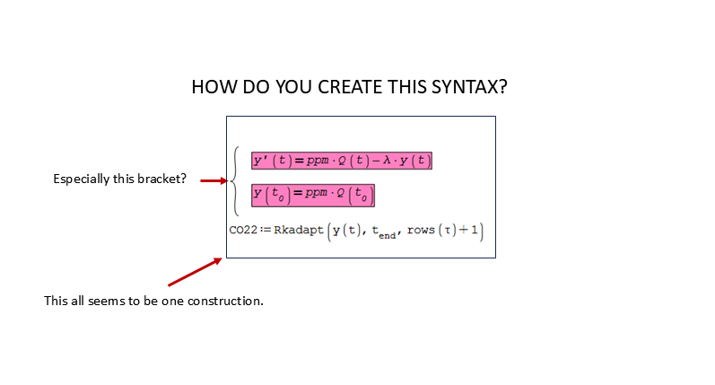

Alvaro,
Two things;
1. How do you create this syntax for Rkadapt.
2. Your integral over tk is equal to my Y as far as I can tell.
CO2 FORCING SATURATION STUDY NEW.sm (599,66 КиБ) скачан 1816 раз(а).
I have tried numerous things, but I still don't understand the difference in the two methods.
Thanks much.
Reg

... 1. How do you create this syntax for Rkadapt. ...
It is the syntax for an ode solver using the "Mathcad toolbox"
