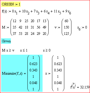

Is there in SMath some tools (plugin) as Given...Minimize/Maximize in Mathcad?

The Plugin is called 「Custom Functions」 by Davide Carpi; there you have Min() and Max() as they behave in Mathcad.

Is there in SMath some tools (plugin) as Given...Minimize/Maximize in Mathcad ?
I think something like this is a RemToDo in Smath
#5 Опубликовано: 18.04.2023 12:34:58
From Smath Forum.
minimizerExamples_Kr.sm (38 КиБ) скачан 73 раз(а).
minimizerExamples_Kr_2.sm (38 КиБ) скачан 65 раз(а).
minimizerExamples_v01.sm (39 КиБ) скачан 69 раз(а).
Maths Simplex_Minimizar_Example_3.sm (139 КиБ) скачан 65 раз(а).
Hi. Also you can see Lagrange multipliers with Draghilev's method and Mathcad solve blocks here: https://en.smath.com/forum/yaf_postsm80940_Mathcad-Toolbox.aspx#post80940
