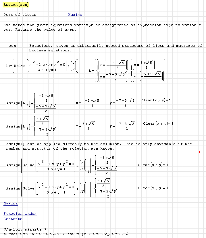

#6 Опубликовано: 05.11.2013 15:25:17
The function Assign() from the Maxima plugin converts a boolean equation into an assignment and displays the result. This is normally used for postprocessing of Solve() and ODE.2() results.

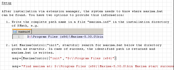

Does the Maxima plugin work with a portable installation of Maxima? (I have wxMaxima from WinPenPack) Or else, Can you manually set the path to find Maxima?
#8 Опубликовано: 07.11.2013 09:57:28
Yes is possible, look the image attached in the first post of the Maxima Plugin thread
