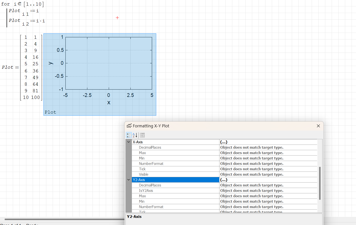

I have just tried to use Smath, after a break of two or three months. I can't get the x-y Plots to work. When I try to adjust the scales, etc, from the defaults, I get the message "object does not match target type" in most/all sections.
I checked with an older file that used x-y Plots - the plots displayed properly, but I still got the same messages when I tried to access the scales, etc.

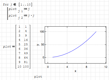

Is this what you mean?
Jon
Windows 11 Home
Jon
WroteIs this what you mean?
Yes.

The XYplot.sm file works and displays fine, but I still get the "object does not match target type" message if I try to format the plot.

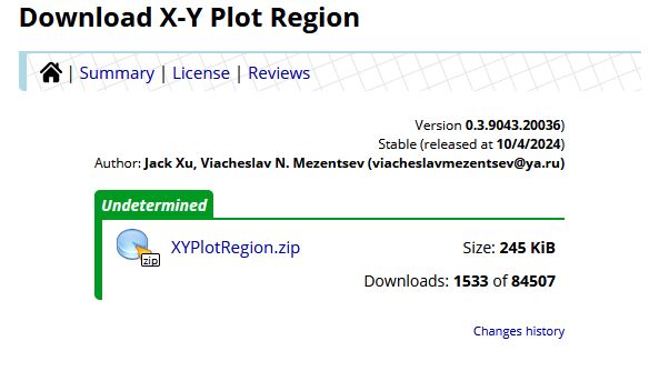

You can install an older version from the list here:
https://smath.com/en-US/view/XYPlotRegion/history
1. Remove the current version of the plugin from the program.
2. Restart the program.
3. Drag the archive with the plugin to the program window with the mouse. This is an alternative installation method.
