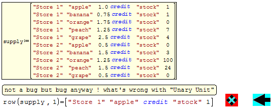

No logic in that observation.
How can I explain if I can't explain to myself ?
Utilities Matrix [Parse Lookup, Truth Table].sm (26,37 КиБ) скачан 1040 раз(а).

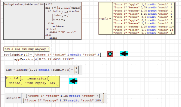

#4 Опубликовано: 06.03.2018 13:54:40
CBG
CBG
Hello Jean
The version "0.99.6638.17192" of Smath Studio does it correctly.
I also propose a small change in the variable "Search"
Carlos
#5 Опубликовано: 06.03.2018 22:39:33
Thanks Crlos,
Your'e right: just search for what is demanded.
