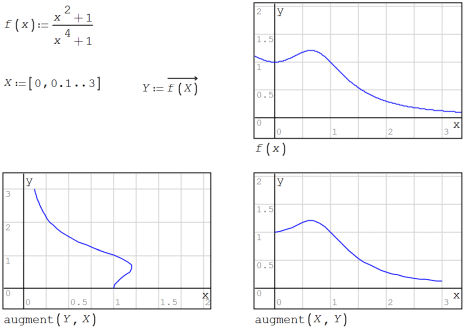

New user, so learning my way around. I haven't been able to find a way to do the follow.
What I would like to do is plot a function where the abscissa is shown on the vertical axis, and the ordinate on the horizontal axis. The function shows wind speed as a function of height, so it's more natural to plot the height values vertically.
Thanks!
#2 Опубликовано: 01.04.2019 01:33:32
Hi Rod. I guess that the easy way is: (1) discretize the domain, (2) vectorize the co-domain and finally (3) plot augmenting in the "reverse" order.
PLOT.sm (4,66 КиБ) скачан 1154 раз(а).
#3 Опубликовано: 01.04.2019 01:50:45
rodp1
rodp1
Thanks. That's exactly what I needed. I don't think I would have ever guessed that sequence of commands.

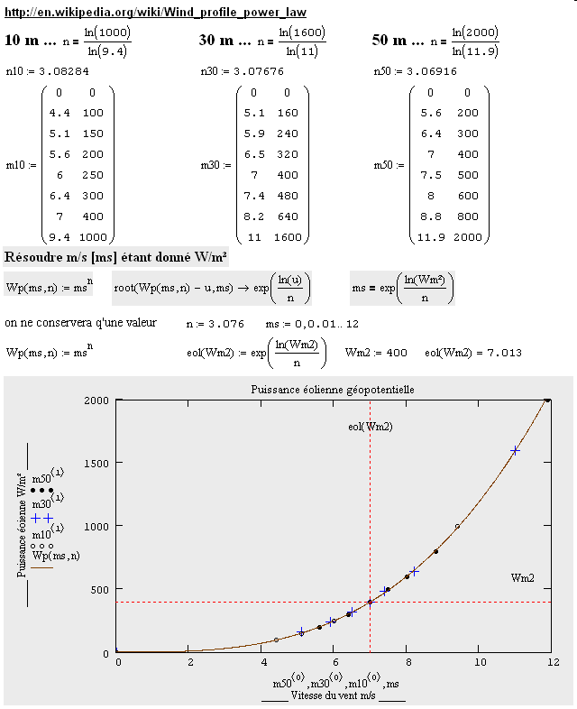

#5 Опубликовано: 01.04.2019 10:16:43
Wind speed is very local, that's why you may just have data.
The Windmill project was done Mathcad 11 [W vs speed].
Here is an image to download ... being converted Smath
Expect today Smath document. Observe the function inverse.
