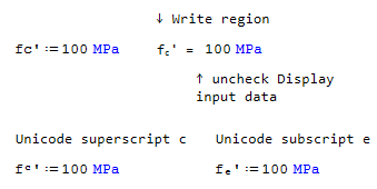

Hi. As Davide says, there are only some few characters for subscripting with Unicode chars. This is a workaround for this case and some others:
fc'.sm (4 КиБ) скачан 67 раз(а).
