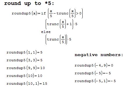

Hello Destory,
Apart from the Ceil function, you can write your own function for this, i have made an example for you:
you can edit the function (extra if loop) if you want it to handle negative numbers differently.
ceil_and_roundup_to_5.sm (7,7 КиБ) скачан 2116 раз(а).
I hope this helps you.
regards,
csb
regards,
csb
Here is the working program for n=5
A bit confusing for n ≠ 5
Utilities Matrix roundup_n.sm (10,19 КиБ) скачан 1893 раз(а).
