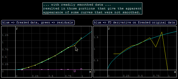

Hello Nicolas,
This is as far as can do from your data. They aren't so nicely collected
as you pretended. Some models will do as well but can fit "Genfit" Smath.
Please: comment ... Jean

... you may prefer this polyfit model ?

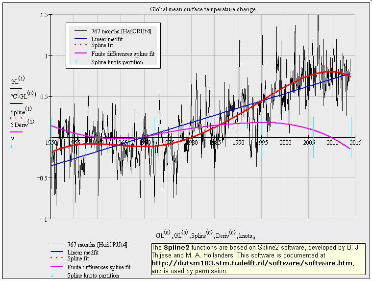

Wroteuntil my age of 62
Oh ! my friend, you are a spring chicken vs Jean.
Smoothing is a rescue tool when no fitting method
is productive [model global, model piece wise ...].
1000's of data sets got well done Mathsoft Collaboratory.
I'm just addict to data.
Cheers, all the best.
