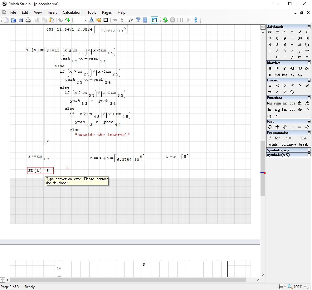

I was playing around with SMath and trying to graph a piecewise function curve. I am receiving a "Type conversion error. Please contact the developer." message.
Any ideas what is causing that? version 0.99 (build 6884)

the problem is that in boolean comparisions you are using matrices instead of scalars (in both arguments, x and um)
