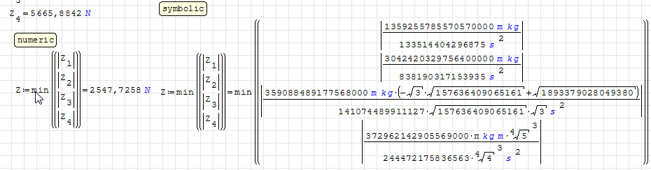

#1 Опубликовано: 15.04.2015 19:43:39
Stumped…
I have a small problem calculating a variable within a routine, that has worked before, but doesn't now..
Error is "units don't match".
When I look at the variables, the units are all the same.. don't see how I can trick the program into believing the this…
Now, I can't seem to paste an image in here and although I have checked the box marked, "attach files to this post" i can't see anywhere to upload files..
If someone could help me solve that problem in the first instance, the initial problem may prove to be a snatch..
Thanks..

#3 Опубликовано: 16.04.2015 05:38:30
The issue is related to the symbolic optimization. Switch the optimization of the definition to numeric to solve the issue.
