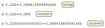

A CAS like Smath and others do not know if
0.123 is exactly = 0.123000000000000
I'm not aware of such an option in Smath
Example from Mathematica 4.0
#24 Опубликовано: 02.05.2018 08:57:09
Explained otherwise in Mathcad/Mathsoft
x^1/2 will output 250 floating point decimals [1/2 is exact]
x^0.5 will output 15 decimals [0.5 is unknown]

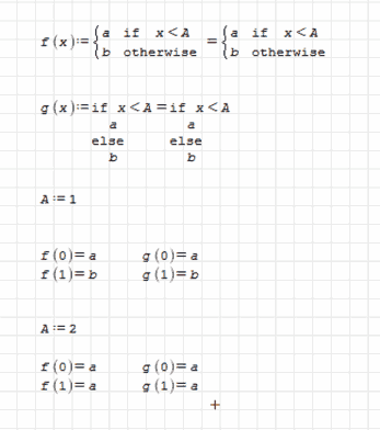

#26 Опубликовано: 02.05.2018 17:45:55
CBG
CBG
Originally Posted by: Alyles
Цитата
The difference comes when the value of A changes after the definition of f(x) and g(x).
For g(x) the original definition of A:=1 remains. However, for f(x) the value of A changes.
I see that the problem is caused by the definition of the variable A, before the functions, changing the definition of this variable after the definitions of the functions, the problem is solved.
This indicates to us that we must be very careful when programming functions when some of the variables that integrate in them have already been defined previously, because we could arrive at erroneous results
cases_ok_cbg.sm (7,02 КиБ) скачан 1093 раз(а).

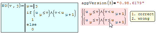

#28 Опубликовано: 03.05.2018 10:16:30
it is evident that one expects the same behavior.
They do behave the same, except for the rare case that I reported.
In mainy instances < or <= won't matter
In other instance it matters to scrap the project [De Boor re-posted in this thread].
In less visible instance, if the form is not appropriate will freak the project.
Same things with Mathcad ... ad nauseum doctored.
No matter the arguments, Smath is correct, does not forgive user incorrect coding.

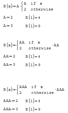

Another example:
The first A is replaced by its value, the second is not.
Not really intuitive or obvious, in my opinion.

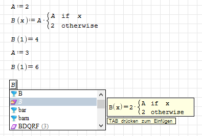

#31 Опубликовано: 03.05.2018 13:02:11
I'm too to not create confusion, however some features are tied to this feature; by removing it:
  • any argument will be preprocessed by smath; this means f.e. that if you place a definition, this will be evaluated despite the condition is met or not (like in if function)
  • the protection against assignments won't work anymore
  • won't be possible anymore to use functions like error()
(you will be able do them using line, though)
