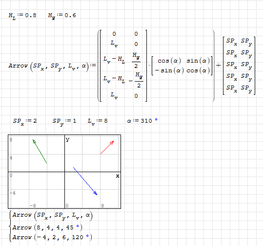

Dear experts,
Sorry if this question is stupid, but I am new to SMATH.
In order to plot some simple vector diagrams (using the SMATH built in diagram) I did the following.
I want to plot the vector from a given start point with given length and angle.
So for the arrow I created a polygon, rotaded and moved it. This works quite well. I als can put the formulars into the plotting input area.
But it would be nicer to define a function e.g. Arrow(start_x; start_y; length; angle).
Is this possible? What would be the syntax?
Is there maybe a smarter way of doing this?
Thanks in advance!
Ralf
arrow1.sm (11 КиБ) скачан 83 раз(а).

Hello Ralf,
welcome in the community
Simply put a function name on the LHS (left hand side) of the assignment operator
arrow1 (r1).sm (12 КиБ) скачан 98 раз(а).
Once you have done it if you want to rename a variable inside the function you can do it at once using the F8 key when the text cursor is inside the variable you want to rename.

#3 Опубликовано: 24.03.2018 17:30:48
Gorgeous application of the 2D rotation matrix.
Few more in there.
Circle_rkfixed Arrow.sm (27 КиБ) скачан 112 раз(а).
