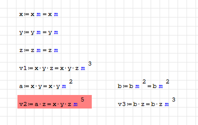

I tried to attach a screen grab that illustrates my question, hope it works!
x, y and z are symbolic variables, I multiplied by unit 'm'
x,y and z evaluate symbolically is as expected.
v1 is as expected, i.e. a cube with unit m³
a is area of rectangle xy and unit is as expected 'm²'
for v2, symbolic evaluation is as expected x.y.z, but the unit is not as expected (m^5 instead of m³ )
v3 is a trial with b as a tester in 'm²' it works as expected
I arrived here from trying to do a much more complicated symbolic evaluation with other units and getting odd results. Maybe I am trying to do something that is not supported?
Any help greatly appreciated!
I suppose my question is "why isn't the v2 result the the same as v1 and v3? and is this supposed to work?"
smath studio version 0.98(build:6103)
Thanks, Richard
#2 Опубликовано: 24.09.2016 09:09:34
It seems that you have found a bug.

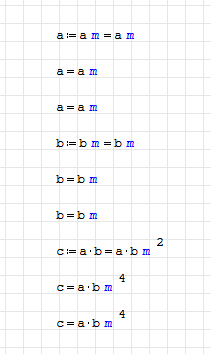

Jean,
Thanks for your suggestion.
Please see below, is this the expected behaviour? (all symbolic evaluation)
Thanks
Richard

#6 Опубликовано: 24.09.2016 19:26:05
With pencil and paper math, it would be plain wrong to identify a quantity with the same quantity times a unit.
This is not better than saying i=i+1 and then complaining that the value of i changes whenever that expression is evaluated.
Correct would be to use separate variables for a quantity and it's numeric value, say x:x0*'m with x0 being a dimensionless number and x a physical quantity.
The behaviour observed is not a bug, just a consequence of inappropriately using recursive definitions.
BTW, be careful with bashing symbolic evaluation. There has been quite some progress recently. Both in bug fixing and in documentation, see Davide's handbook on user functions in the extension manager.
You can't always expect symbolic evaluation as you want. It's all about knowing the limitations and watching which expressions are actually stored in a variable or function. The dynamic assistant is your friend.
#7 Опубликовано: 25.09.2016 07:47:38
richard_gardiner
richard_gardiner
Hi Martin,
Thanks for taking the time to share your thoughts.
I already tried using an auxilary variable for symbolic definition and then defining a second one with the unit as you suggest (see post 6).
The problem with this workaround is that subsequent calculations are defined in terms of x,y,z and evaluated in terms of a,b,c which seems to me to be clumsy / non elegant and confusing for anyone that I might show the calculations to, so I suggest this is not 'correct', certainly not ideal. Maybe it is the case that the correct way doesn't exist yet but that's ok.
What I am looking for is a way to define a symbolic variable as having a unit without it relying on other auxilary variables, maybe this is not possible?
Further, consider the example below, multiple evaluations of a and b do not result in m², m³ etc, however, a second evaluation of c does but further repeated evaluations do not.
Also, who is 'complaining' and 'bashing'?
Richard

As pointed out by Martin, the general correct way should be to name the "object" differently from how it is named the dimensionless value (f.e. consider "a" the edge's length in meters of a rectangular prism and "x" his length divided by meters; "d" will be the area of a side in square meters, "v" the volume in cubic meters):
However you can still use your syntax, if you want, just pay attention on the order of definitions.
When you define (:=) something:
  • If something was already defined (:=) the value is stored (see IfDefined(...) or the dynamic assistance to check if it was already defined)); the value is anything on the Right Hand Side (doesn't matter if has a numerical value or contains unknowns);
  • If something is not yet defined, the name is stored;
In your example "d" was defined after x and y -> the values are stored (x*'m for x and y*'m for y; hold the mouse over d); then you ask to display a result for d * z -> (x*'m*y*'m)*z -> according on what is defined on the canvas: x is x*'m, y is y*'m, z is z*'m -> x*y*z*'m^5
If you define d:x*y before defining x and y, d will contains just x*y, then further evaluations will replace these unknowns with their values, if available:
Another way is to use a procedure - line(...); since it is not evaluated at his definition, his content will be replaced only when will be evaluated (when it is used on the RHS to define a variable or you ask for a result):
