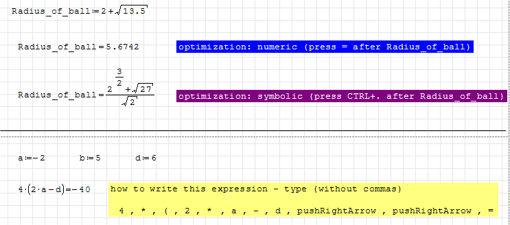

+Another programming question if I may. I have a expression. Given a=-2, b=5, and d=6. Example 4(2a-d). When i do this expression one way I get one answer and another way I get a different answer.
Example #1 2*a-d*4 = wrong answer
Example #2 [(2*a)=ans.#A] end box [put answer down again then - d =ans.#B] end box [put 4*ans.#b= correct answer]
Am I working the program right or is there a way to link all the expression together the right way by doing what is inside of the parenthesis first then multiplying the answer second. Also which tutorial that any body knows about can teach me this basic programing expression so I can learn the right way the first time? Thank you Kevin

you were wrong to write the formula, nothing serious
regards,
w3b5urfer

Many thanks for your post w3b5ufer. I was able to figure out how to program a:=-2 b:=5 and d:=6 expression well enough. I still have problems understanding the other expression thou. Is there a pdf any where that teaches that aspect? How did you come up with Radius_of_ball=5.6742 answer?
The := sign is supposed to designate something after it like x:=2 designates x=2. So where does 5.6742 come from? Best Kevin Since I posted this question I have found your Wiki site and have been working on Useing SMath as a simply calculator. I found this to be very helpful but a question arises. Is that pdf finished or is it a piece of work in progress? The reason is it explains some thing and does not supply a example for the answer. What gives as I am new and trying to figure your site out? Best to you thou Kevin
