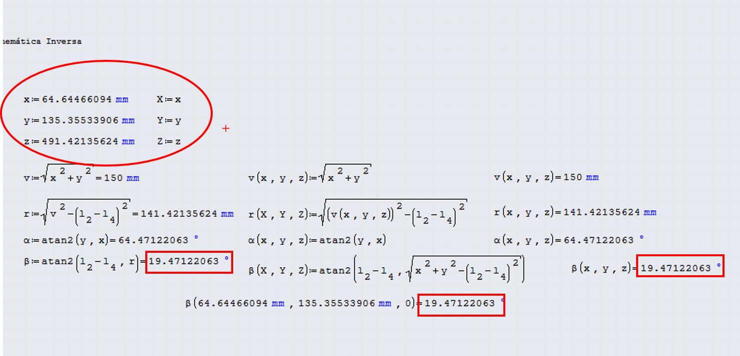

Hi, I am having some issues Here,
As my english is very bad, I prefer to show you the picture about my problem
If I make step by step caculations, the answer is correct (Which is 19.47°). When I try to make them using user functions, the answer is wrong even if I am using the same values for parameters.
#2 Опубликовано: 22.04.2016 02:50:11
Mike Kaganski
Mike Kaganski
This is a bug.
The problem is triggered by your naming. You use x, y throughout your functions. It seems that actual parameters names interference with dummy parameters names. Here it's evident: arguments-bug.sm (2,61 КиБ) скачан 1264 раз(а).
To workaround, please change names of parameters in your functions, namely in atan2. E.g., you may make it atan2(yy;xx):= ....

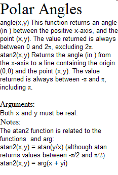

Your coding is not correct:
"atan2(x,y) => returns the angle in radian from the 'x' axis to a line
containing the ORIGIN [0,0] and the point [x,y]. The value returned is
always between -π and π including π. Both x,y must be real".
That definition is correct and universal. What's confusing is Smath built-in "mwatan2(,,)

#8 Опубликовано: 23.04.2016 00:29:02
Your atan2(y,x) is right with your Smath version.
But there is a bug in your version wrt to "atan2(,,)
the universal implementation and bug wrt Smath 5346
which version respects the maths adopted convention.
... and by same token: mwatan2[,,] is bug in Smath 5346.
Two birds in one shot !
Your own screenshot shows that there's NO error in mwatan(#,#). Maybe you were confused by the names of arguments?

By definition, atan2(y,x)≡arg(x i*y)
Please notice that atan2 has y and x in "reversed" order.
What is "UNIVERSAL IMPLEMENTATION" of atan2? Link please.
Answer: WRONG, bug in your Smath version.
"Universal Implementation" of atan2 is as adopted since the very first day of FORTRAN,
respected in Mathcad 8/11 but not in your Smath version.
