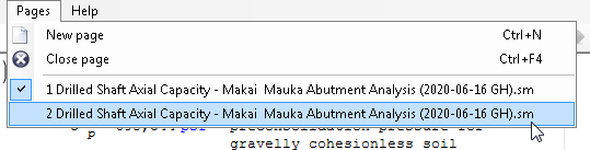

Very strange... It is possible that you had the same file opened twice in the same instance?
2020-06-25 11_56_34-SMath Studio - [Drilled Shaft Axial Capacity - Makai & Mauka Abutment Analysis (.png
That is the right answer, common mishandling.
