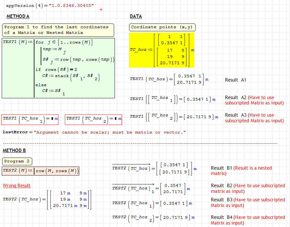

When working on a slope stability analysis problem, I had to use an intermediate
result which may be a nested matrix or just a simple matrix.
This intermediate result depends on the 2D cordinates (x,y) of the center of the
assumed slip circle and other factors.
However, this intermediate result cannot be used automatically to continue as
I have to manually input these values.
Details are given in the sm file and image. Kindly help me.
Nested Array_Problem2.sm (18 КиБ) скачан 75 раз(а).

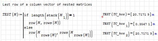

Hi Amarasekera. Hope this helps.
Nested Array_Problem2.sm (21 КиБ) скачан 74 раз(а).

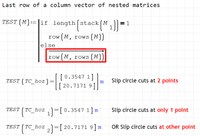

Nested Array_Corrected.sm (21 КиБ) скачан 80 раз(а).

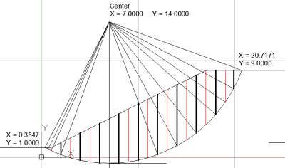

Image of ACAD drawing, with slip circle cutting at two points on the two horizontal lines.
Otherwise, cuts at one point on one horizontal line and the other on slope line.
For demonstration of first case.
