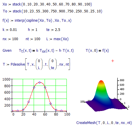

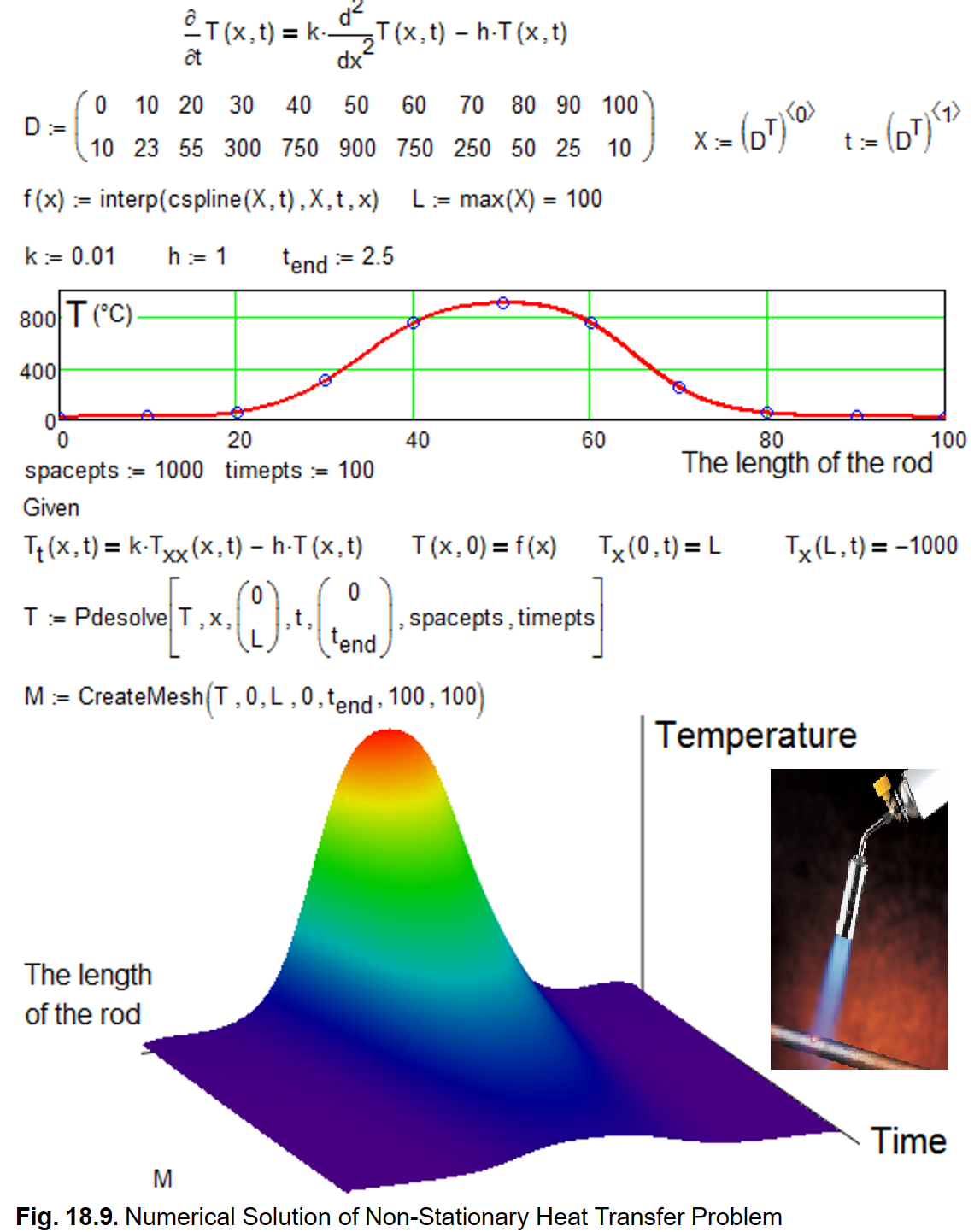

We heated the rod in the flame of a burner.
How will it cool down?
Non-stationary mode!

And what about the ICs?
We must use one numeric not symbolic method!

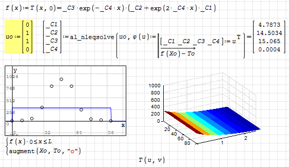

#4 Опубликовано: 06.07.2023 06:51:41
For your data set D ... 3 options:
1. Smath ainterp, cinterp ...integrate/solve(4)/zap derivative.
2. Mathcad l_p_c implemented Smath [1rst derivative, integration]
3. Thiele Smath ... symbolic derivative, integration.
If you have interest in methods [2,3] I will attach.
Since nearly ~ two weeks, Smath Studio can't be downloaded.
Replaced by Smath Solver ... a damned crippled version.
Cheers ... Jean.

#6 Опубликовано: 06.07.2023 09:53:10
Thanks!
I would like as here
Thiele_0 Model QUICK.sm (24 КиБ) скачан 72 раз(а).
Maths EDU [l_p_c_splines TOOLBOX] Copy.sm (584 КиБ) скачан 75 раз(а).
These two documents are SS 6179.

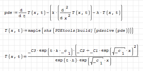

#7 Опубликовано: 06.07.2023 14:33:10
Alvaro Diaz Falconi
Alvaro Diaz Falconi
... And what about the ICs?
Using maple, you can try to use a maple "component" or a maple plot, which gives more flexible access to maple structured functions.
Also, there are some numerical procedures for pde's in Maxima.
Notice that in Mathcad the border conditions for δT(x,t)/δx are not considered for obtain the solution.
With SMath, you can try to adjust the curve choosing good guess values in the yellow vector.
pdesol_num.sm (14 КиБ) скачан 71 раз(а).
