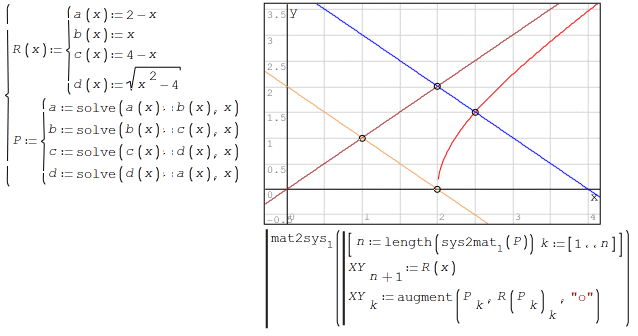

Hi. In the attached, can plot points and functions, but not both in the same plot.
Double Integral.sm (10 КиБ) скачан 73 раз(а).
The old style works otherwise.

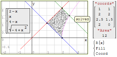

You can fill the region of integration.
Double Integral.sm (16 КиБ) скачан 74 раз(а).
Double Integral FillRegion.sm (17 КиБ) скачан 65 раз(а).

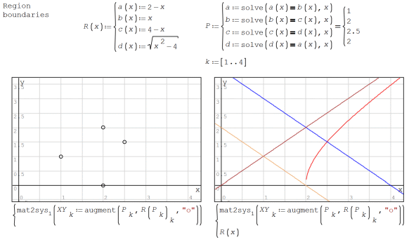

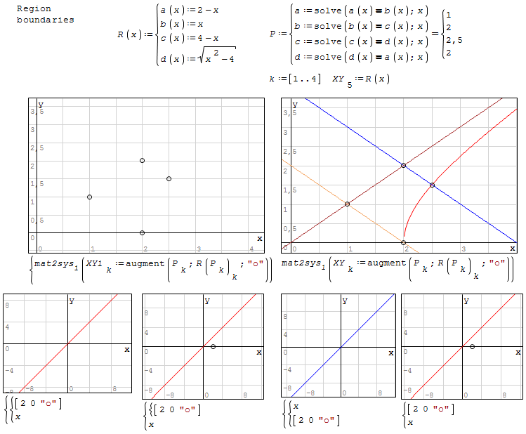

#3 Опубликовано: 17.11.2018 06:40:28
The behaviour of arguments in nested lists seems to be unpredictable, at least I don't see the rule.
Thus, re-arranging objects works but I don't know why.
Double%20Integral_Kr.sm (11 КиБ) скачан 76 раз(а).

Hi Martin. Thanks for the tip. I guess that I take this form, from you suggestion:
#5 Опубликовано: 17.11.2018 18:18:39
... personally: I prefer the more conventional form.
The example in view may fail in other instance(s).
3 in one: functions, solutions, fill-in region.
X_Y Plot wisely [Solve] Boundary.sm (39 КиБ) скачан 81 раз(а).
