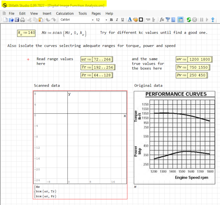

Yes, I have downloaded the image already.
It starts to give error on Ms:scan(Mc,k1,255)
`Argument doesn't meet to expected kind`.
Perhaps the image2rgb doesn't work under linux.
M matrix is filled with zeros, nothing else.
Hi. I remember now that the worksheet also use Mean, from statics plugin, and I put it definition at left margin, but disable. Maybe it's that one. This version have embed image matrix, and except for the XYPlot, I guess that it have not any other plugin.
I have statistical plugins with linux.
In windows, with same plugins and setting it solve.
And matrix is not full of zeros.
image2rgb is not working under linux.

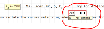

Hi. You can try to eval only Ms outside the plot for read the error, if it is not an specific error related with the plot.
#10 Опубликовано: 14.06.2021 16:15:44
Ruben Sidranski
Ruben Sidranski
Ms is not defined. As you can see, I changed kc as well.
#11 Опубликовано: 14.06.2021 17:46:10
Alvaro Diaz Falconi
Alvaro Diaz Falconi
Nope. The message says that "M" is not defined, not Ms. And M is for load the image, not for doing some process. Try this version, with the image embeded in the worksheet:
https://en.smath.com/forum/yaf_postsm71146_Approximation-of-a-functional-curve-in-a-digital-image.aspx#post71146
and check if you can update the plugins for images.

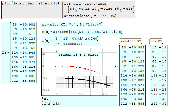

#14 Опубликовано: 16.06.2021 08:15:51
Elsid,
My offer via Paint is valid, but delicate from too thick graph.
My other tool is via Tracer 15 [freeware]
Paste image as is in Tracer, capture at will pixels.
Each capture is stacked in vector, obviously noisy.
Once in hand, Ksmooth the Y vector ...
We have Ksmooth as a Smath utilities.
Once smoothed, spline ... Job done.
Have a good day ... Jean

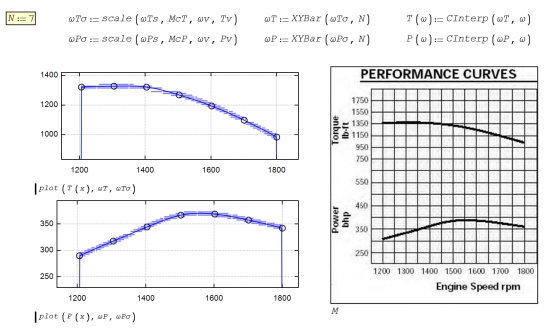

#15 Опубликовано: 16.06.2021 11:55:45
The image2rgb() doesn't work with image importing.
image2rgb has a procedure for fast image reading that somehow doesn't works in mono
I'll try to update a beta version with an alternative code ASAP.
#16 Опубликовано: 19.06.2021 08:14:15
Just released a beta version of the Custom Functions plugin for latest Stable SMath Studio. Please test if now it works under linux.
overlord 20.06.2021 01:29:00
#17 Опубликовано: 20.06.2021 01:29:20
It worked for my linux setup.
Thanks.

#18 Опубликовано: 23.06.2021 12:21:39
... once pixels in hand ► Ksmooth ► final fit.
