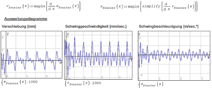

In some case there ist no Result in v(fourier) and a(fourier) diagram but this message:
need some Help please.
Thanks Thomas

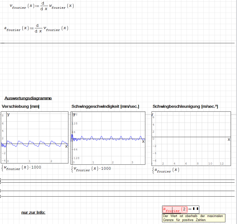

#8 Опубликовано: 26.01.2021 06:19:37
Thomas Stampa
Thomas Stampa
Hallo everyone...
the script works in Version build:7030 and doesnt works in the latest build 7610. see the different screenshots here.
The Smath-script is attached.... Maybe there ist a lot for optimising...
I´m very thankfull for further tips..
Greatings Thomas sorry for this bad english.... it isn´t as good as I want.... Файл не найден.Файл не найден.Файл не найден.

Check and cross check your formulas and how you defined the equations (e.g. "[" for a matrix). At the moment, if I define x:0,0.1...1, the result for V.fourier(x) says that the "result is above the max allowed positive number"
In addition, W.fourier cannot be calculated, but the graph is visible
