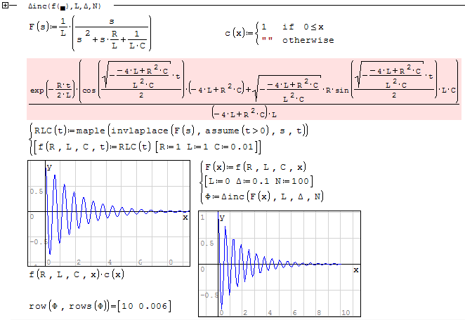

Hi, this is a snippet for numerical inverse Laplace transform. You can find time response of a system expressed in F(s) form.

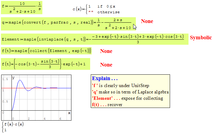

That one was well covered, two last remarks:
1. That Smath does not trig example [1], rather in terms of exp(,)
OK, unfamiliar ... but much faster as it involves only one numerical approximation.
Whatever: it's the Maple business, from which Smath depends upon.
2. last visit [red/cyan[ is sometimes of importance as demonstrated.
InvLaplace2 Otherwise.sm (49,53 КиБ) скачан 1280 раз(а).
#42 Опубликовано: 24.09.2018 10:21:12
... when you deal with Laplace stuff, open your school book,
that will help setup Laplace Algebra appropriately, like this:

Any real use for this old style inverser,
vs Maple export c/w parameters that works much faster.
Saludos ... Jean
Laplace Maple Parametric Export.sm (15,2 КиБ) скачан 1288 раз(а).
