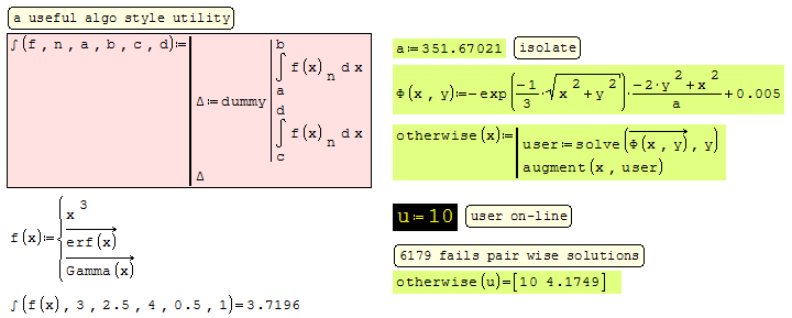

Interesting the implicit/recursive discrete solver.
Few more techniques/tools in these two Smath documents.

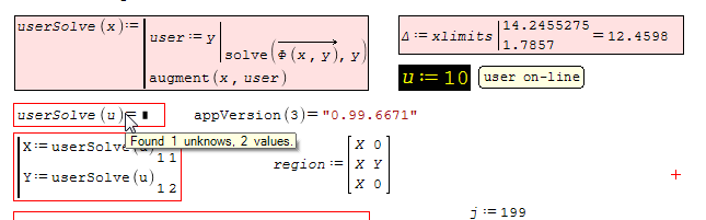

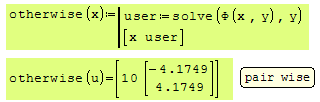

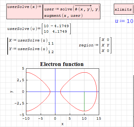

For sure, more than correct as your solve(,,) gets pair wise solutions.
Yes, the lobe is symmetric around the 0 datum.
#7 Опубликовано: 28.06.2018 21:08:22
... now I get pair wise solutions. But not augment !
