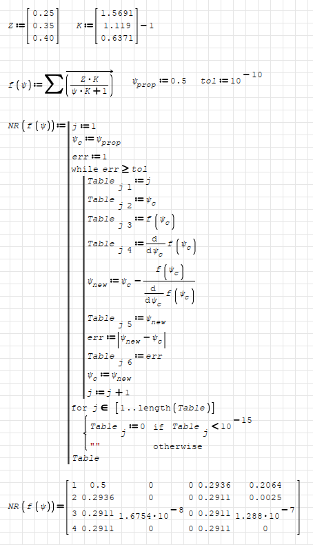

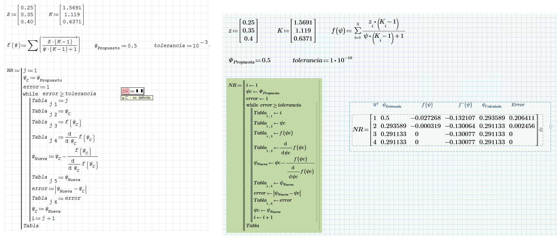

How can I do this loop while?
what am I doing wrong?

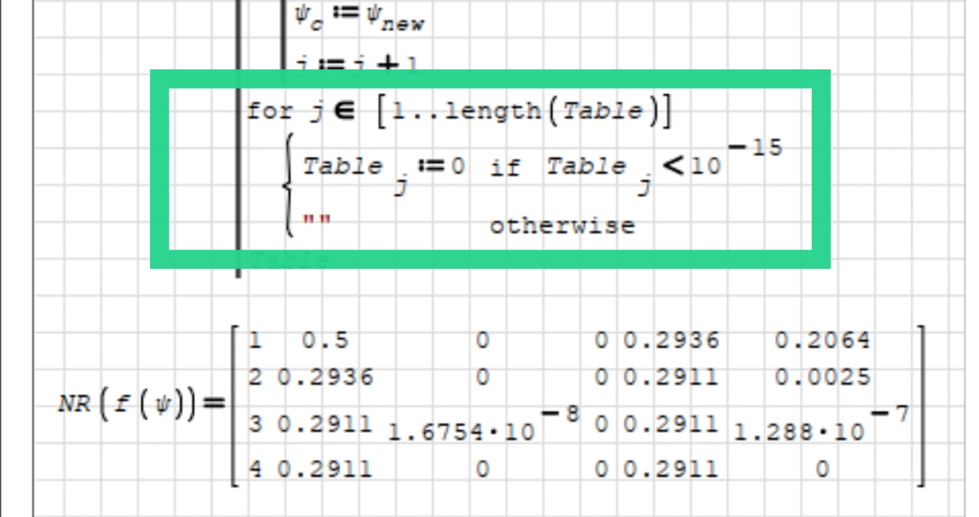

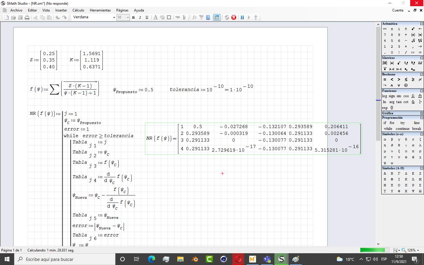

I think it already came out, but how do I make the numbers that are almost 0 not appear as 2.72 * 10 ^ -17?
#3 Опубликовано: 11.09.2021 15:23:39
Add a check for every element if they are lower than something.
And if they are, make them zero.
what function does this have?

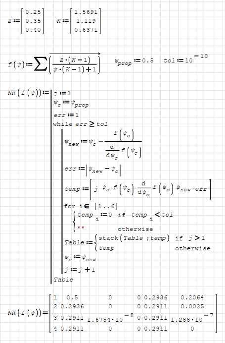

That is cases(), it is in Custom Functions plugin.
I would prefer to write your algorithm like attached.
It is just my preference by the way.
