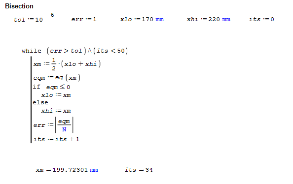

Here's a transparent, home grown bisection routine that does the job:
RC_forum_nonlinear_b.sm (79 КиБ) скачан 78 раз(а).

Many thanks for the quick solution.
I'll include the code in the inner loop of the procedure.

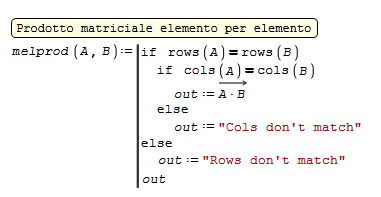

#6 Опубликовано: 10.03.2024 17:32:48
#7 Опубликовано: 11.03.2024 04:32:55
Thank you! With your improvement the speed is significantly increased
Wonderful
