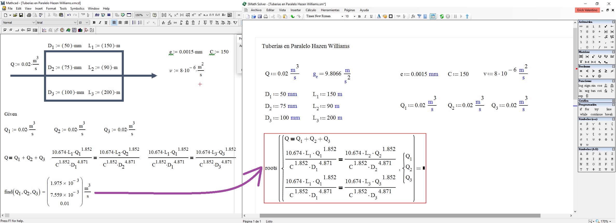

Hello! What's up
I would like to know how I can replace the "given" command from Mathcad to SmathStudio, I know that such a command does not exist in SMATH and for that there are other tools
I just need to find the flows Q1 Q2 and Q3 from a parallel pipe using the Hazen Williams equation, without having to do as many expressions
Thank you very much

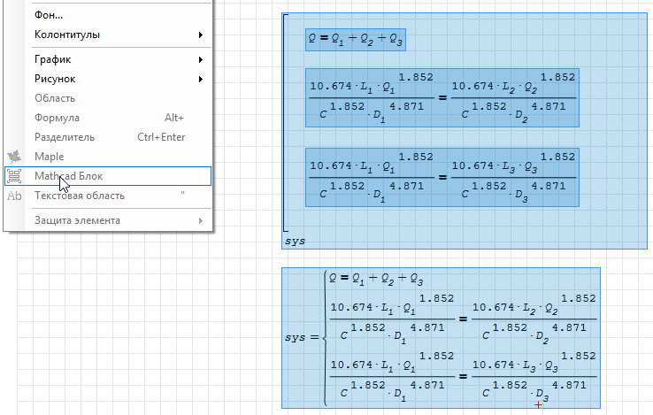

You can use Mathcad Block region for this.
Click to enlarge

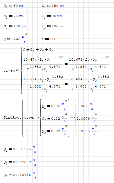

AFAIK, roots() won't work with units.
You can use FindRoots() for that purpose.
Regards.
tuberias.sm (11,75 КиБ) скачан 1237 раз(а).

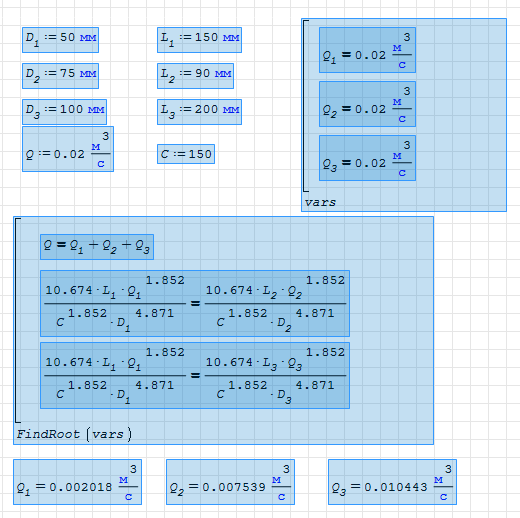

Or like this.
tuberias_uni.sm (12,14 КиБ) скачан 1202 раз(а).

#6 Опубликовано: 23.03.2022 00:32:03
How FindRoot() can work under block with only one argument?
The first argument is implicitly substituted by the block itself. Then the function is called with two arguments.
Click to enlarge
