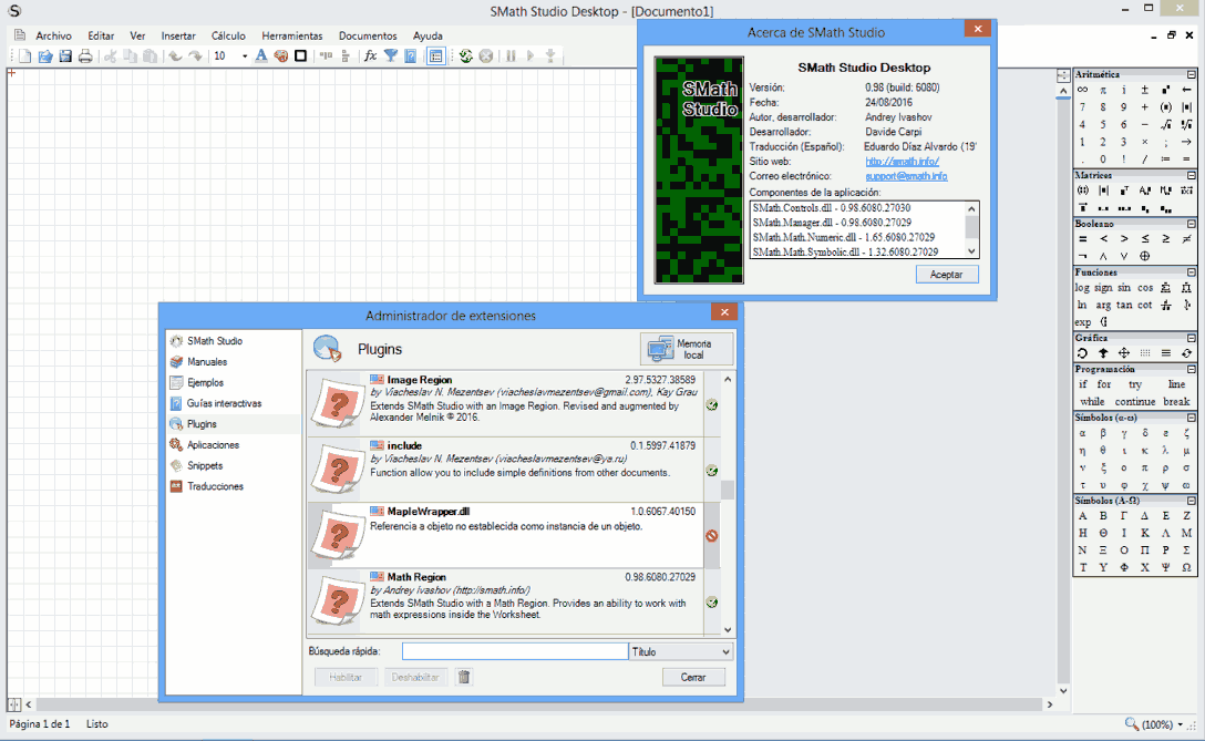

The same problem as I reported earlier.
The Maple plugin does not start when the Smath Studio program is changed into Spanish.
Carlos
