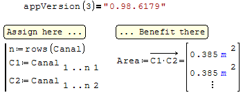

Is this a bug or am I doing something wrong?

Hi. I guess that not a bug, nor doing something wrong. What I see it's a parenthesis problem. With yours last two approximations what you get is that SMath evaluates first col function, then matrix product. But in the first example, and as you can see in the symbolic evaluation, what SMath do is first the matrix product, then try to get the col. So, the problem it's about that there are not an obvious way except both that you use, for change the operation order, i.e. a parenthesis question.

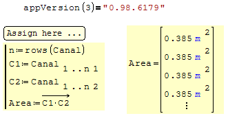

#3 Опубликовано: 10.11.2018 12:25:17
Well, using submatrices has solved the problem.
You can be right, it seems col() is calculated after matrix.
But I don't think it is related to paranthesis. I have tried nearly every possible usage way of parantheses with col() function, no success so far
If submatrices have no problem with same usage, then somehow this must be related col().

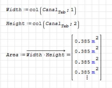

#4 Опубликовано: 10.11.2018 22:38:17
Just wrongdoing ... doctored.

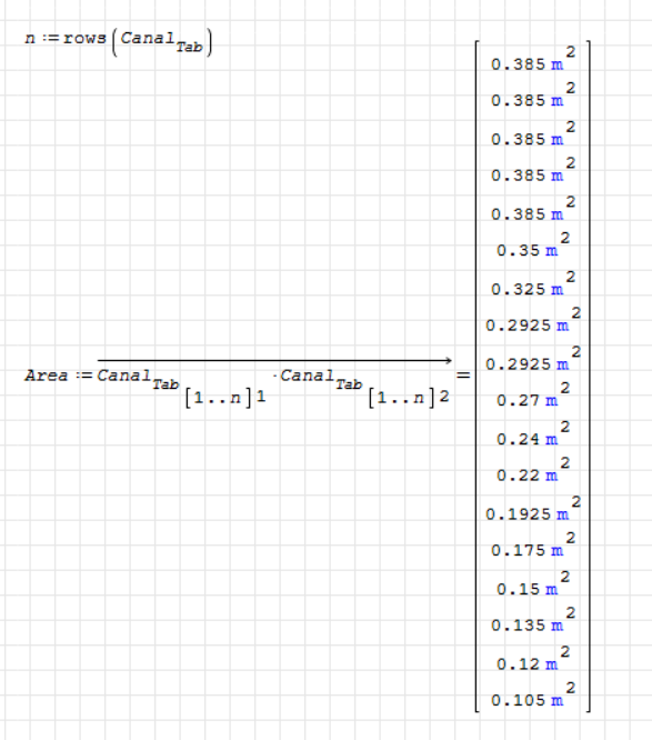

#5 Опубликовано: 11.11.2018 07:54:37
Well Jean,
Thank you for your reply.
But this is how I had done this calculation previously, for years. I don't want to do it like this.
I am trying to calculate it via vectorize. It looks more elegant on the paper.
Which I did by the way, you can see the picture above.
#6 Опубликовано: 11.11.2018 09:44:45
... then add more elegance and space saving, backward compatible.
#7 Опубликовано: 11.11.2018 10:14:29
Well, I used to do that too
It is at the end of smath file by the way.
I will stick with submatrix and vectorize method.
It is the most space saving method I could think of.
Thanks and regards
