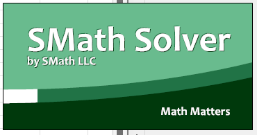

When I went to open SMATH a couple of days ago, the program notified me that there was a new version of SMATH and prompted me to install it. I did so, and SMATH will no longer open. I have tried several things to get the program to open including uninstalling and reinstalling the software from the website, but no luck. The loading bar that moves along a curved medium green stripe during the startup of the program always pauses and then aborts the program (as shown in the picture).
I am running Windows 10. Is anyone else having this issue? Thanks in advance!

There are several plugins that prevent an old v0.99 version of SMath from opening, it is also possible that some Plugins are preventing your new version from opening as well; In the interest of debugging, did you remove/disable all of your currently installed plugins?
When you say that it will not open; does the startup SMath Loading screen popup and just close, or do you have no response/reaction when launching the application?

The initial screen pops up and the white bar begins moving along the medium green stripe, but then pauses and aborts the program. I am not sure how to disable any plugins for SMATH outside of the program itself (i.e. how should I try that without opening the program?). I don't think I have additional plugins installed, but I figured uninstalling the program and then reinstalling it would fix any potential issues involving plugins though. Any further thoughts would be appreciated. Thanks for such a quick response!

Without reinstalling, try to navigate to the %APPDATA% path and rename the SMath folder (something like SMath-original), then launch SMath Studio again.

I tried uninstalling again per your recommendation @Kenny and when I went to delete any leftover files, I discovered that the Units file had not been removed. I had modified the Units file in August so that it would default to imperial units and had forgotten about this. I'm not sure why, but apparently SMath is not fond of the old Units file in the newest version. I deleted the modified file and reinstalled, and now it works. I will have to figure out how to modify the Units file again, but at least it is working! Thank you both for your help!

It is possible that your modified units file is fine. Please be aware that SMath will fail to open if those xml files (all files contained within that folder) contain duplicates entries of eachother. (e.g. You can only have (1) file that defines the term "gram" once). Same goes for constants, there can only be (1) declaration of a constant. My guess is that the new install inserted the default Units.xml, which came at odds with your customUnits.xml (you can either have one or the other), not both.
